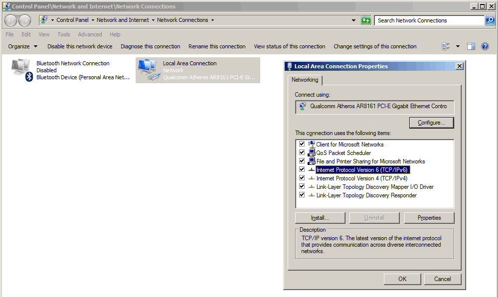

What if you just go into the adapter settings in Windows 11 and remove support for ip6?
You probably not using it and don't need it and would be just as well without it.

I could not find the adaptor setting in Windows 11, re. ipv6. However on the Router, I disabled the ipv6 feature. Now the FreeFileSync syncronises in Windows 11.
Disabling the ipv6 in the Router is not elegant, as goring forward many websites would use ipv6.

ncpa.cpl (from command-line, or maybe from Start menu?) should take you to Network Connections (at least in Win7), & from there you could disable IPv6 altogether, if you wanted.
ipconfig.exe, should show you the state of things.
