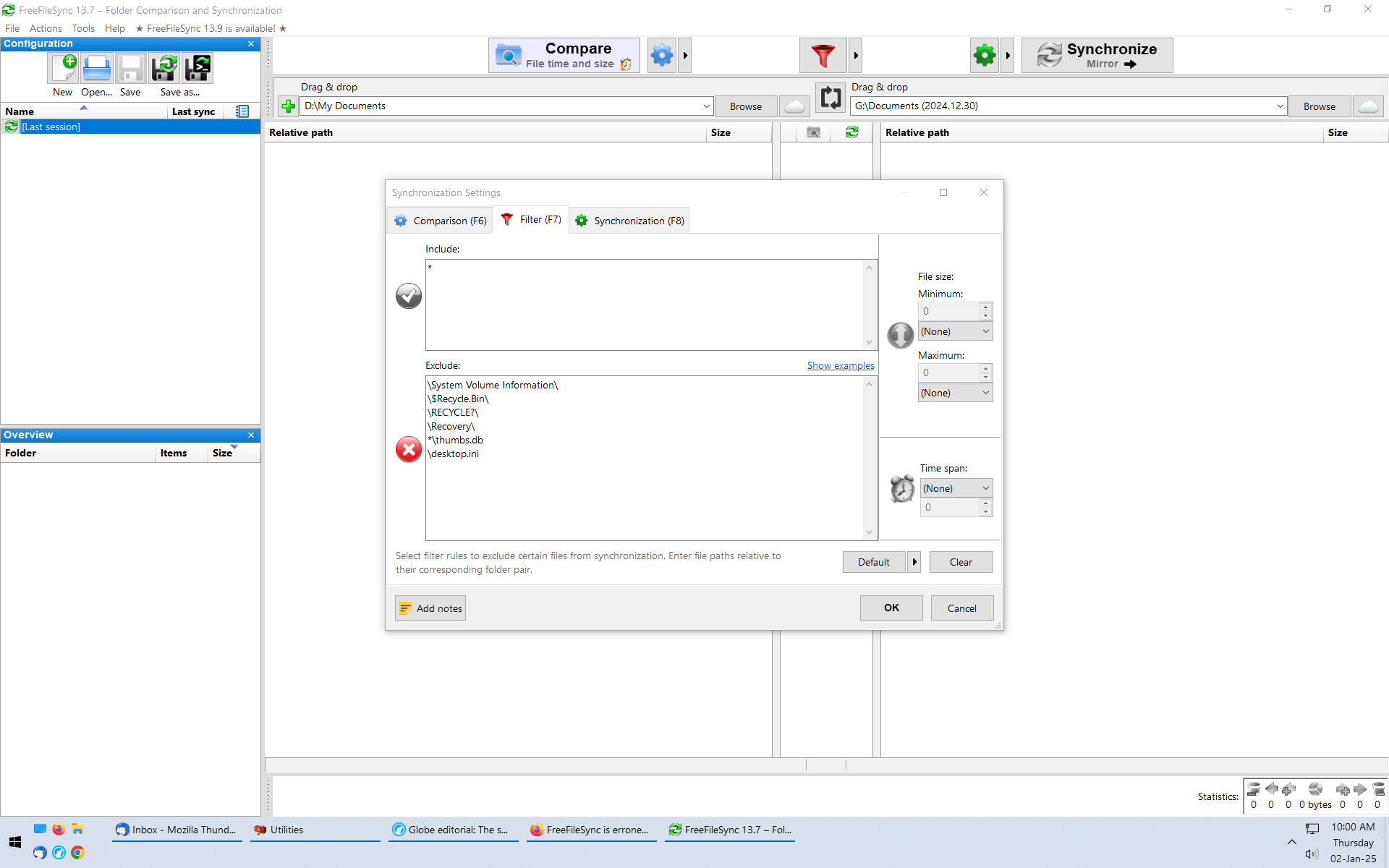

Post a screenshot of your 'exclusion' filters. It's likely that 'Desktop.ini' was removed. The default user folders each contain one of these files and it controls the icon, name, and some other stuff. The file was probably mirrored to the destination, Windows now reads the 'desktop.ini' file in the destination folder and changes the display name accordingly. These files are hidden. Unhide them, delete them from the destination, and review filters to prevent future issues.
- Joined: 29 Dec 2024
thanks, looks like that's fixed it. 'desktop.ini' was not in the exclusion filters - not sure how or why, I'm pretty sure I hadn't even looked at the filters. So I added '\desktop.ini' as shown in the screenshot and all looks fine now (I'm guessing the backslash at the front is needed?).
