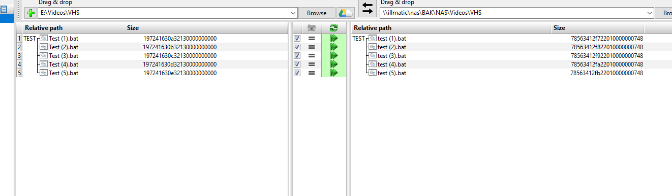

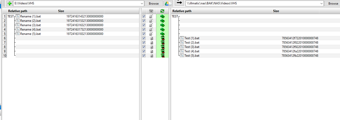

Interesting, now we're getting somewhere.
It looks like it might be a problem with Drivepool, and not FreeFileSync.
Something is causing the File ID to change, but only in certain circumstances.
I've attached a successful rename (test >Test) and a failure (Test > Rename).
I'll try making a post on their forum, to see if this is expected behavior.

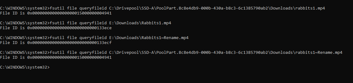

This is definitely Drivepool's fault, I've attached another screengrab to illustrate.
Thanks again, for all the help. I would have never figured this out, otherwise.
