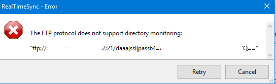

same here
can anyone help?
FFS fine, but RTS show me this error.
can anyone help?

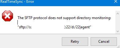

SSH same

- Posts: 5
- Joined: 5 Nov 2017
Help?I've changed the error message accordingly. Zenju, 28 Apr 2017, 10:59
- Posts: 7523
Just remove the folder from the list of folders monitored by RealTimeSync. Maybe RealTimeSync should do this automatically when importing a FreeFileSync config?
- Posts: 5
And which folder RTS will sync after delete. ofc it do, i import FreeFileSync config, did it many times. This is not resolve my problem.Just remove the folder from the list of folders monitored by RealTimeSync. Maybe RealTimeSync should do this automatically when importing a FreeFileSync config? Zenju, 05 Nov 2017, 13:40
Why FFS complete task fine, but RTS?
