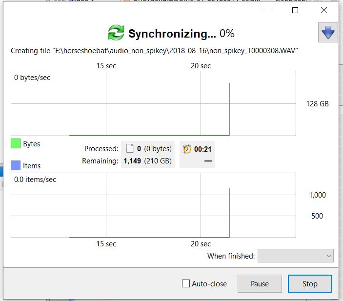

I'm trying mirror one old external drive to a newer one.
I can copy files from the old drive manually, albeit it takes time.
About 50% of the old drive's data was mirrored using FreeFileSync until a 'plateau' in the copying rate happened when the data transfer dropped to 0% for a very long time. At this point, I aborted the mirroring and tried again multiple times, but keep hitting the same 0% transfer each time with no improvement.
I'm on a Windows 10, using FreeFileSync v13.8 Donation Edition.

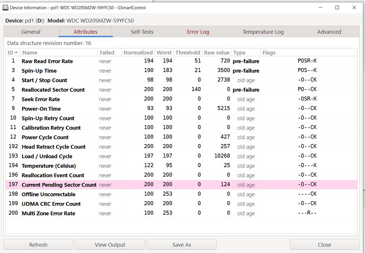

I bet the old HDD is not 100% healthy and that file exists within a bad spot on the drive.
I would recommend downloading Gsmartcontrol and checking the Attributes tab for that old HDD. If there are any pending reallocations, reallocated sectors, or uncorrectable errors, the drive is bad.

_/\_ Thanks for the suggestions.
As suspected GSmartControl showed some damage indicators. So, I guess it is indeed a hardware issue :|.
