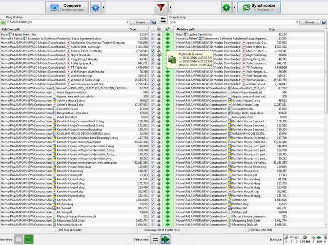

I've just started using this program. Fortunately, I noticed in preview after doing a compare that it was going to copy old files over new ones wiping out days worth of my work!! I would have killed myself for losing so much work.
The screenshot is attached where it says Right Side is Newer yet you can see the arrow pointing right.
I can't believe it's a bug in your program since it has so many positive reviews so I must be doing something wrong. Would someone help please?

The "two way" variant propagates any changes: If both sides are equal and you overwrite a newer file with an older one on one side, FFS will also propagate this change.

"Two-way variant" -- I assume it's for syncing both ways (i.e. if files on A change, then they are copied to B, and vice-versa). And this is likely the most common way people would be using it.
Regardless, it is totally unacceptable for a software like this to copy old files over new. I have never heard of such a thing regardless of what options you select. Unless you clarify further, I am tempted to now give this program a 1-star review so others can be warned of this problem.

My respectful reply Please:
I did NOT overwrite newer files with older ones. I just did a simple comparison between my laptop and desktop computers -- and this was the first time. **YOU** need to see the screenshot I have attached above which shows the dates of a file on both sides (the yellow pop-up which shows when you hover the cursor as shown above). Your program is showing that the file on the right side is newer but the direction of copying is left to right.
Fortunately, I did not press "Synchronize" blindly, otherwise it would have overwritten the newer files with the old ones from the left.
- Posts: 7535
Maybe you manually changed the sync direction? If two folders are compared for the first time with "two way" variant (= no database files existing yet), FFS will default to "overwrite old with newer files". BTW what version are you using?

Also, if you have written this application or you are a software engineer, you probably know that bugs can occur under very special conditions that are somewhat uncommon in usual practice (say the user set some conditions for the sync using date-time, size and archive bit and set/reset something else somewhere else, which created that condition for the bug). Bugs can thus be very elusive. BOTTOM LINE is this -- the software should not under any circumstances, without warning the user at least twice, overwrite new files with old ones.
I have submitted an irrefutable piece of evidence above (the screenshot) and I'm ready to send you the high-res pic. of the same. If I were you, I would not need further evidence.

The screenshot merely shows that sync directions are set so that new files are overwritten by old files. This is *not* a bug in general. The only case this situation would be a bug is if this were the screen after a fresh first compare with "two-way".

Again, respectfully submitting to you Zenju --
1. SCREENSHOT. I am referring to the "Synchronize" button on the top right side. You are probably referring to the arrows along the middle that show the direction of copying. Please see the Synchronize button which has small text below it that says "Two way".
2. CLEARER EXPLANATION. Allow me to explain even more clearly please:
IF--
a) Your Sync button is showing "Two way" sync,
b) The Compare button is showing "File time and size", and
c) The file dates are as shown in the screenshot the left files are older, the right newer),
THEN --
Why is copying direction reversed???
It shouldn't matter what I did before or how I got to the above point since the proof is visible above in the failed logic (as long as you believe me that I didn't tamper with the screenshot).
Am I missing something or are you missing my point?
I won't spend further time explaining this to you as I have already spent enough and you seem to not understand my basic point-- now even explained in a programmer's language above. Good luck and thanks for interacting with me so far. I hope this app doesn't cause damage to someone's important work as it was about to do so with me.

Again, the screenshot does not proof a bug. The situation shown in the screenshot can happen legitmately in certain cases. If you think it is a bug, you need to provide proof, e.g. steps to reproduce or be able to reproduce your test case. In this case I'd have a closer look.

I feel you are wrong in your assessment of the clear IF-THEN statement I provided above.

I think the main issue is about the notion of "File time", versus running a two-way sync, and particularly the purpose/use of the ffs_db-file(s) in case of two way syncs.
At the risk of getting burned, or adding to the confusion rather than reducing/resolving the matter:
As described for the Two-way sync setting :
"Identify and propagate changes on both sides. Deletions, moves and conflicts are detected automatically using a database."
I'll try and explain as I understand FFS to work for a simple 1:1 two way sync (Zenju, please correct me if I am wrong)
The ffs_db file in each left or right sync location contains all file sizes and modification dates as per the end of the last FFS sync run on that left- respectively right-location. When now running a comparison, the content of each location is first compared to the content of its (local) ffs_db file. Any changes to the locations content compared to what is stored in the local ffs_db-file is considered to be more recent than the last FFS sync was run, even if the modification date of a file that has changed is earlier than the last time FFS sync was run on that location.
If the above is the case in 4world's left location, and the content of 4world's right location has not changed (compared to what is stored in its ffs_db file), the file change date/time in the left location is more recent than that in the right location and thus needs to propagate left to right, even if the right-side file has a more recent modification time than the left-side file. And this seems to be the only correct two-way sync action !!!
If the content of both the left and right location differs from what is stored in their respective ffs_db-files, this constitutes a conflict, which needs to be resolved manually.
So, for a two-way sync the definition "File time" needs to be interpreted as "changed since the last sync", rather than "having the most recent modification date/time".
I can understand that this might be ground for confusion.

@Plerry: You are absolutely correct.

Plerry,
Thanks for participating in the discussion as your comments have added great value to the debate.
1. I've understood the copying algorithm you describe but as engineers, we must design systems that are idiot-proof and fail-safe. This algorithm is obviously neither; because it was about to destroy newer files (assume I was an idiot and pressed the sync button, so it would have failed in a "non-fail-safe" way destroying new data).
When the app compared the left side file times with its own ffs_db, and determined that those files had been changed later, a more intelligent algorithm (fail-safe) would have additionally seen that there was a conflict in dates on the two sides, and thus would have raised a red flag (say another type of conflict flag) to save the user's data. The program must assume (IMO), that the user's 1:1-sync computers are regularly synced and that the local times on each machine are within seconds of each other (that is the assumption that will make the software fail-safe), and thus at least raise a red flag; it should not under any circumstances overwrite new files without a double confirmation from the user. At least, I would have implemented this code this way (that's how I was trained -- we used to design sophisticated medical instruments and could not afford a single failure no matter what).

I absolutely see it the same way was as Plerry does.
@4world:
In the matter of a 2 way sync tool, FreeFileSync absolutely behaves correct.
If the user replaces a newer file by an older one, it is his own decision to do that.
Your point seems to be, that FFS should be able to protect the user from himself.
But that is more or less a feature of a backup program.

So the facts of this discussion seem to be:
- FFS detects a conflict for example, if a file on both sides has been changed.
- 4worlds suggestion is, as far as I understood, that the situation, when a newer file would be overwritten by an older one, should also be rated as a conflict.
Am I right, 4world?
So maybe this could be implemented as a compare option for a further release of FFS, Zenju?

5. Sync it (FFS copies file version 2 to the right, OK)
6. UNZIP archive to the left folder. You get the file version 1, with older creation time
7. Try to sync. Now you will see from-left-to-right direction despite right file (is version 2) is newer than left one (version 1).
I agree that is not very obviuos behavior. But in other side it works according the algorithm - the left side file was [re]created in earlier version by the user and need to be copied to the right side.

- Posts: 7535
The whole discussion is just about a specific manifestation of the more general problem of the user accidentally corrupting his data. The proper solution is to keep versions of deleted/overwritten files.So maybe this could be implemented as a compare option for a further release of FFS, Zenju? JustAnotherUser, 08 Feb 2017, 17:29

Brilliant example evm. Thanks.The easy way to reproduce the situation:

- Posts: 2997
@evm
I believe this should read...7. Try to sync. Now you will see from-left-to-right direction despite right file (is version 2) is older than left one (version 1).evm, 08 Feb 2017, 18:09
....7. Try to sync. Now you will see from-left-to-right direction despite right file (is version 2) is newer than left one (version 1).

Today I've encountered the same problem for two-way-sync (v11.29 - 16.12.2022) and I beleive I know the source of the problem.
First of all this is a SERIOUS BUG! In any condition a newer file(by date) should never be replaced with the old file(by date)! This is A.B.C. This is 2 + 2 = 4
The source of the problem for my scenerio is; I'm using synchronization over dropbox with 2 computers.
Thus for each sync there is a sync.ffs_db file created; and apperantly; freefilesync only relies on this file, so when you change computer; this file still be effective but the freefilesync thniks it is the same computer and same sync project is running.
When you delete this file; everything compares as expected.
I suggest deleting this file before every two-way sync.
This is unbelievable to replace newer files with older files.

- Posts: 2997
There is a very simple solution in FFS for your use-case.
But it is not via a FFS Two-Way sync, but rather via a FFS Custom sync variant.
There you can select
for "Left side is newer" to "Update right item", and
for "Right side is newer" to "Update left item"
That may already be the default Custom configuration.
