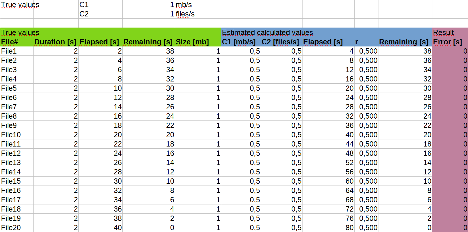

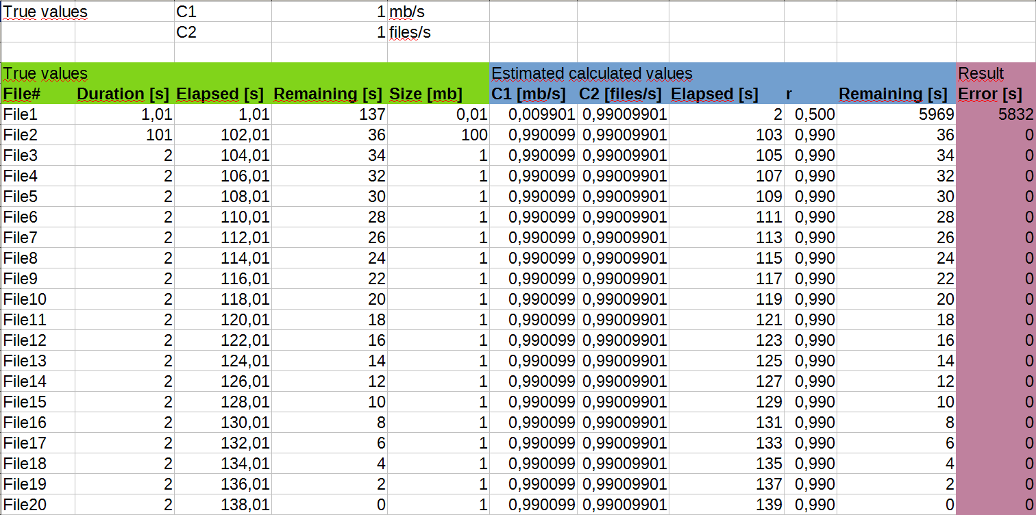

Thanks for feedback! I think we have a misunderstanding, of course we shall not have an recursive algorithm. I have attached a spreadsheet to describe how it works with an example.
2019-11-09 07_56_37-Calculated.ods - LibreOffice Calc.png (60.34 KiB) Viewed 3804 times
2019-11-09 07_56_20-Calculated.ods - LibreOffice Calc.png (73.07 KiB) Viewed 3804 times
Calculated.ods
(18.24 KiB) Downloaded 479 times
