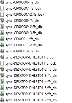

it is possible to save the ffs_db files not in the target folder? If 2 Pc sync the Folder at the same time, one of them make a new file and renamed it like *_1.ffs_db. And then we have 2 or more files of them and nobody delete it.
Best regards
ffs_db files to other folder possible?

From the list of *.ffs_db and *.ffs_lock files you show, it is not clear if they reside in one and the same folder or in different locations. Nevertheless, as you seem to still the use of ffs_lock files enabled, it is not clear (to me) how this can happen.
