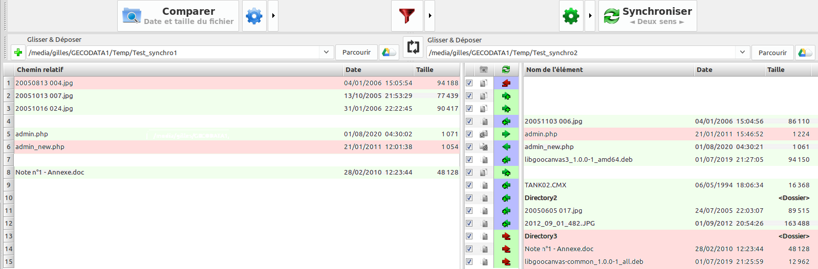

I am sad but I must say that I agree 100% with JDB.
There has been a lot of discussion about the FFS interface here but the new 11.1 does not solve the problem and even makes it worse.

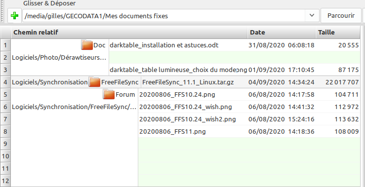

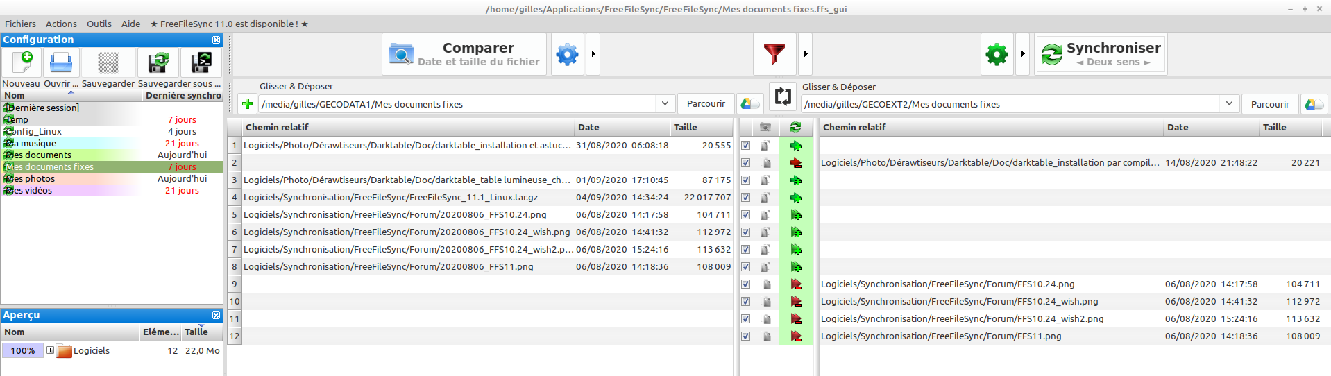

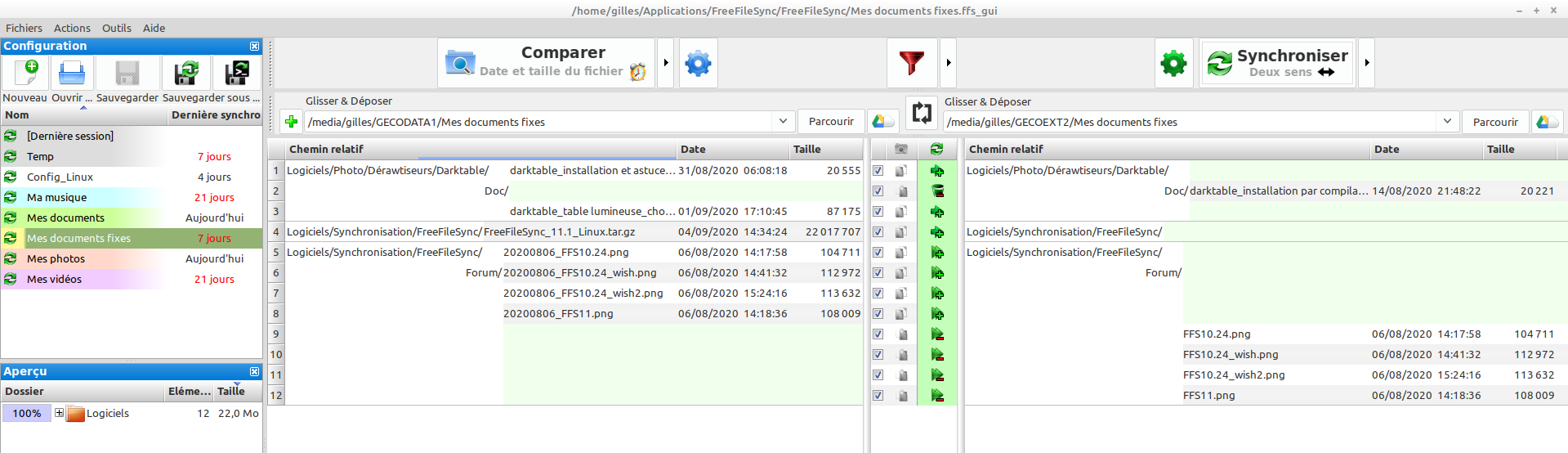

Look below, I understand even less the display of the directories with the 11.1, with the end of the directory name over the beginning !
FFS 10.24
FFS 11.0
FFS 11.1

The most confusing element seems to be a lack of separation of item names and parent folder. The first item is "glued" together with its parent while subsequent are not, which is a remnant of the old 10.24 view. Adding a few vertical lines seems to improve the UI significantly and also simplifies the code:

The most confusing element seems to be a lack of separation of item names and parent folder. The first item is "glued" together with its parent while subsequent are not, which is a remnant of the old 10.24 view. Adding a few vertical lines seems to improve the UI significantly and also simplifies the code: Zenju, 07 Sep 2020, 08:02
First of all, the lack of separation of item names and parent folder is not confusing to me, cause its the normal way to give folder and filename in Linux.
What I see is that FFS is very good software, and many of us here really appreciate it for its excellence in file synchronisation. This must be remembered!
But the discussion on flat vs tree file structure highlights the fact that some details can be improved on the interface :

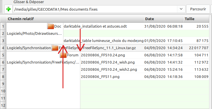

1/ Vertical lines are a good start but there are still some small details that could be improved for a better FFS. What is annoying is that the vertical separations are not aligned, which makes the whole thing messy.
20200907_Zenju_grid view with file icons_not aligned.png (53.94 KiB) Viewed 4372 times
And for that, it would be simpler to have a path column and a filename column!

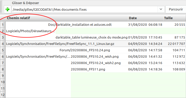

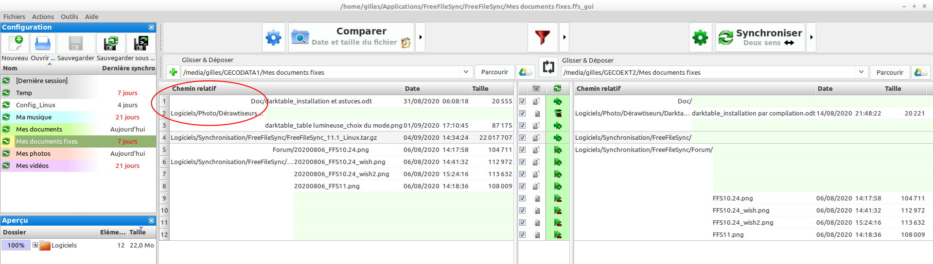

2/ Even when displaying the icons, it is not natural to have the name of the last directory above the directories containing it
20200907_Zenju_grid view with file icons_directories.png (10.75 KiB) Viewed 4372 times

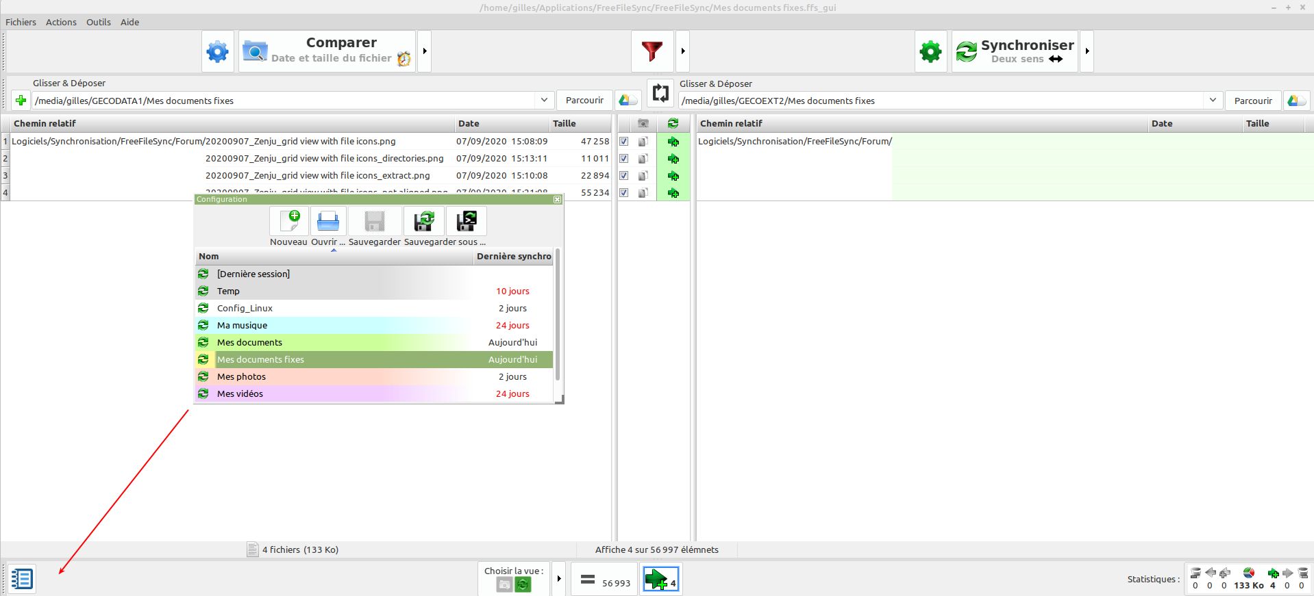

5/ A great improvement of 11.1 is that floating panels are now resizable for Linux users... but they always stay in foreground :-( The space gained on the main interface makes it easier to display long paths, but it remains hidden by the window in the foreground. Possible to reduce it to an icon like the logfile?
