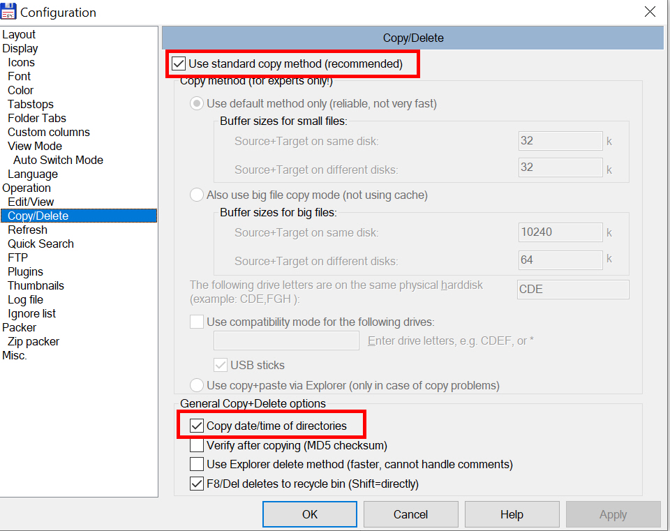

- Posts: 2997
You can discuss as much as you want.
Instead of re-inventing the wheel, (at least the Windows version of) FFS uses the standard Windows routine (the same one as used by Windows File Explorer) for copying files and folders, in which copied over folders will have a date/time as per the moment of copying.
See also here.
See also here.
- Posts: 7535
The problem isn't exactly the copying routine, it's more fundamental: When a file is created/deleted it changes the parent folder's modification time. This means fulfilling the requirement of copying folder modification times would necessitate (1) an additional pass over all folders at the end of sync. (2) This is further complicated by the fact that folder modification times are often not supported, thous have the potential of creating a "never in sync" situation.You can discuss as much as you want.
See also here. Plerry, 20 Feb 2022, 15:39

@Plerry: ist not a re-invention of the wheel. Please understand whats the problem is. To use the explorer integrated routines are a crap.(limited to 255 chars since NT4, modifcation date is often not correct for dirs including a lot of subdirs f.e.)You can discuss as much as you want.
for that reason tools like totalcommander (ghisler.com) have implemented aditional routines for copying folders. There is an extra option to configure that behavior.
And yes, TC uses the standard explorer routines.
It cannot be too much effort to implement these option into ffs.
- Total commander directory copy option
- TC-Copy_delete-options.jpg (406.71 KiB) Viewed 17719 times
