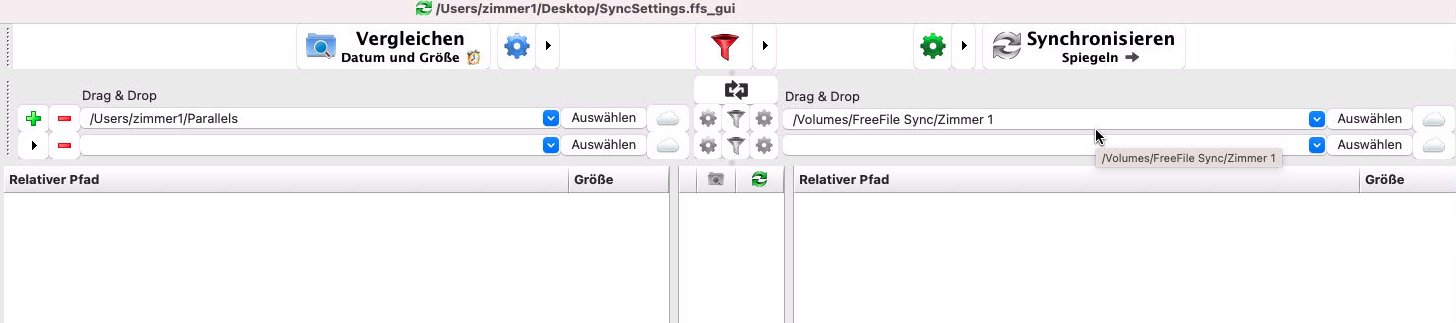

I'm using macOS Ventura and I wand to sync a folder of my Mac to a network folder (located on my NAS in the local network).
So if I want to do this in the app everything works fine
its the german version but you can see the target of the mirror backup job: /Volumes/FreeFile Sync/Zimmer 1

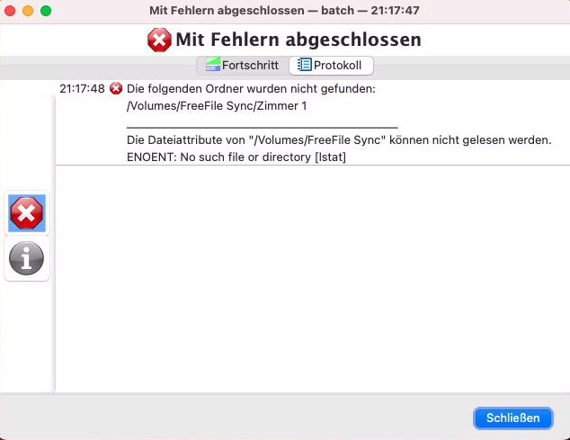

If I save the job as a batch file and I double-click the batch file I'll get this error (see the screenshot below)
translated to english: the following folder could not be found /Volumes/FreeFile Sync/Zimmer 1
The file attributes of /Volumes/FreeFile Sync/Zimmer 1 could not be read
How can I fix this ?

I was able to narrow down the problem a bit:
The batch file works if I open the finder windows of /Volumes/FreeFile Sync/Zimmer 1
so the content of the folder which wants to be synchronized hast to be open in finder ....then the batch file works
It will not work if I only use "connect to server" im macOS
I have no idea about Mac, but if you add a closing slash, or enclose in quotes, does that make any difference?
/Volumes/FreeFile Sync/Zimmer 1/
"/Volumes/FreeFile Sync/Zimmer 1"
"/Volumes/FreeFile Sync/Zimmer 1/"
