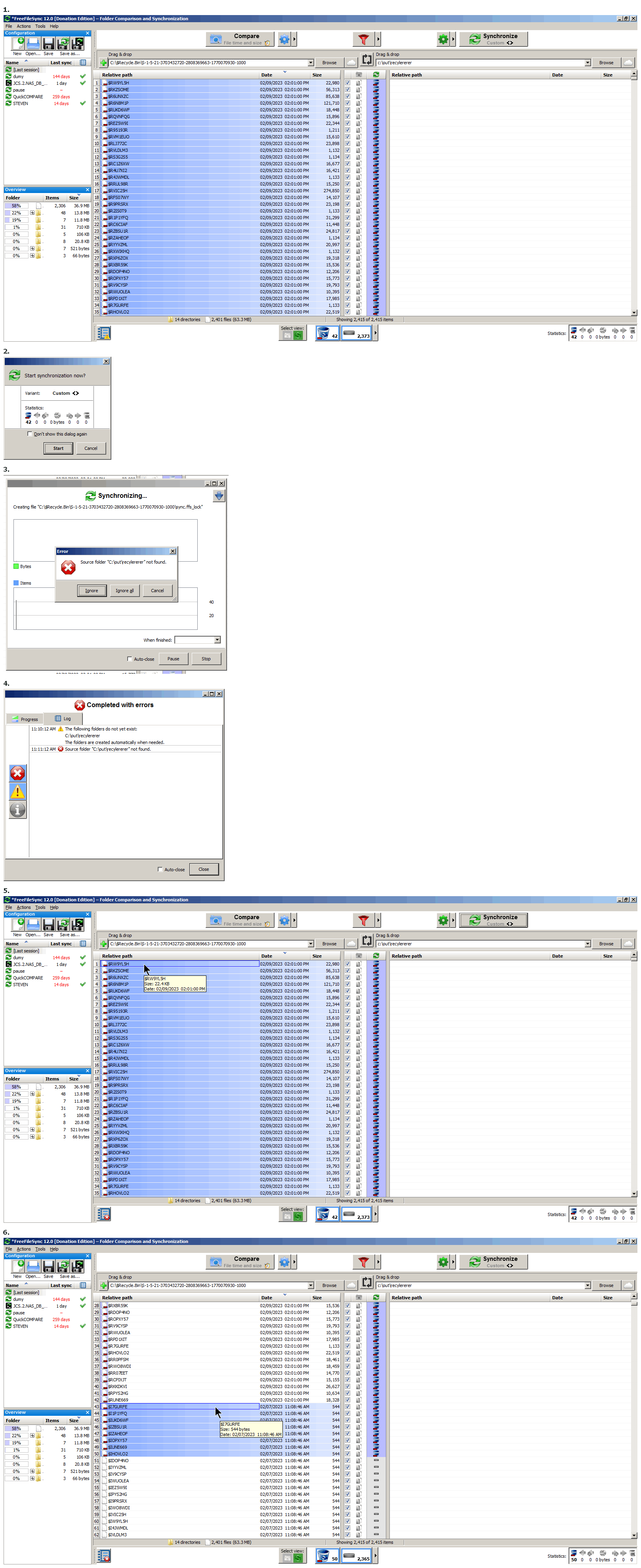

LET ME GO THROUGH THIS AGAIN...
Time 2.
This time (& I dated all the files, 2-9-2023), went through (seemingly) the same scenario...
Selected the files, Alt+Left #1, sync dialog shows I'll delete 42 files from Left #2.
#3 is odd, cause it says "Source" folder not found.
But in fact it is the Target folder? Is it? Considering the actions that will happen are to the items on the Left? Anyhow.
#4 again references Source folder.
#5 shows all the files that were selected, remain.
#6, I tried some of the $I*.* files, & got the same results, that nothing got deleted (though not any "ERROR_PATH_NOT_FOUND" like my first attempt?)
Oh, & I did remove *recycle.bin* from the Exclude list.
I'm not quite sure just what I did to accomplish the above, but I did, heh.I'll confirm the current condition - kind of.

If I then Alt+Left & try to "sync" (delete) those $I*.* entries, I get:
Cannot read the attributes of "".
ERROR_PATH_NOT_FOUND: The system cannot find the path specified. [GetFileAttributes]
Time 2.

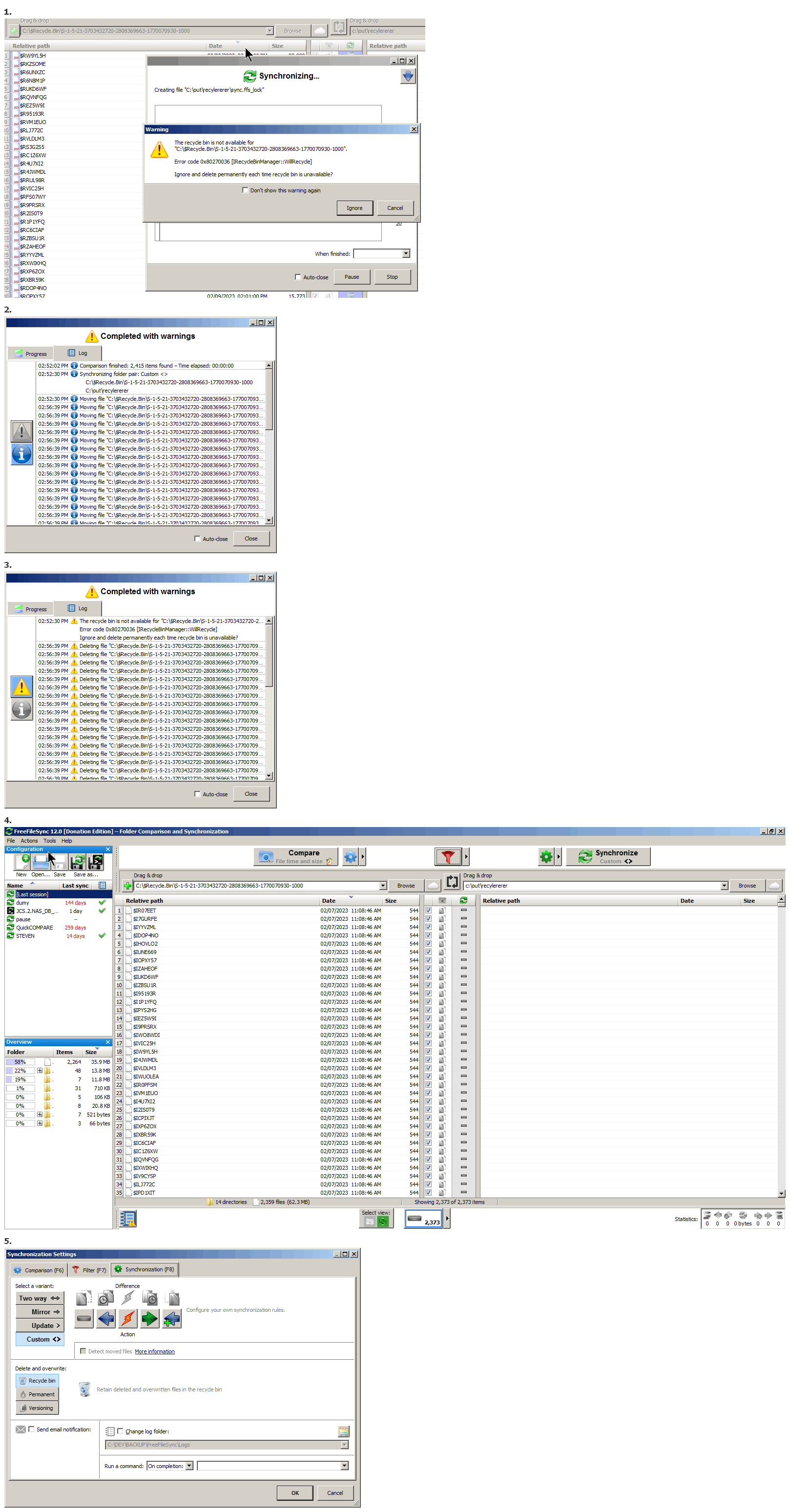

@therube: works as designed. FreeFileSync won't go through with a sync, if the source folder (on the right in this case) is not existing. Otherwise things like temporary network drops could result in data loss.
OK, in that case, I created the Target end first, & it worked.

Did I understand correctly that this is a new version 12 behavior algorithm? In previous versions for many years there were no problems with the above task.
If so, what is the correct way to create my task to empty the users' recycle bins (without deleting the bins themselves)? Just set a specially created empty folder in the right half of the window?
I have no idea if there was a change, as I had never tried anything like what you described before.
Though on my end, by creating the empty directory on the right did allow the deletions to occur.
