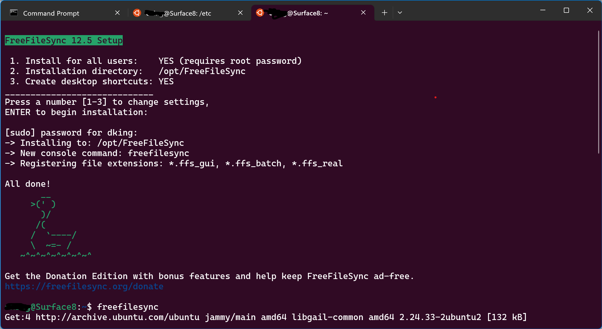

Hi databoxer,
In your case you might want to try running the Linux version of FFS on your Windows computer.
Windows now has WSL 2 which is a full installation of Ubuntu Linux. Windows Subsystem For Linux.
I use both Windows & Linux too. Linux does a better job, I think, with really big files and also directories with several thousand files. There are other Linux apps that I use on Windows to manage large file systems or remote connections with extra large directories.
I just successfully installed and ran FFS for Linux on my Windows 11 machine.
WSL Windows Subsystem for Linux is available in the Microsoft Store.
FFS first complained about a missing dependency. sudo apt install libgtk2.0-0 solved that problem.
Then, you need to correctly export the DISPLAY setting with:
set DISPLAY = 0:0
then, you can run "freefilesync" and the Linux edition of FFS will launch and run normally. You do this from a Ubuntu terminal window.
The Windows C: drive is automatically mounted for you as /mnt/c
You can even install the GUI file manager Nemo if you wish. I run it on all my Windows computers.
Let me know if you need any further details for installation.
