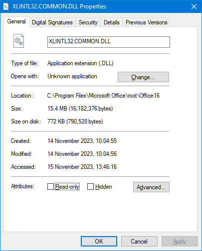

I should provide a screenshot of the EXE compression option in action -

(I'll grant you, that particular file does compress extremely well.
Didn't have it, so downloaded it & sure enough 700KB.
Threw libavcodec_plugin.dll & aticaldd64.dll, both ~16 MB to ARJ/7-zip, & size knocked down to ~6 MB.)

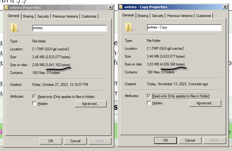

Using FreeFileSync in Windows 11, I backed up some compressed files (file-level) from an NTFS partition to another NTFS partition, but the destination files are not compressed.FreeFileSync (FFS) will gladly sync (file-level) compressed files for you. Plerry, 12 Nov 2023, 16:04
Is there a trick to make the destination files compressed too?

This sound like you are using the NTFS compression feature on a folder (or perhaps on the entire drive), and that folder (or drive) is part of your sync.
When using the NTFS compression feature, files are compressed at the time of writing, and uncompressed at the time of reading. As a result, the user, or any software tool reading such a file is simply presented with the uncompressed data, and unaware it comes from a compressed folder (or drive).
So, in these cases FreeFileSync (FFS) will sync such files in their uncompressed form.

That's not correct. FreeFileSync detects compressed files and copies them without uncompressing. Same for sparse, and encrypted files.As a result, the user, or any software tool reading such a file is simply presented with the uncompressed data, and unaware it comes from a compressed folder (or drive).
So, in these cases FreeFileSync (FFS) will sync such files in their uncompressed form. Plerry, 16 Feb 2025, 11:34
The issue here is that NTFS compressed attribute can be inherited. Most likely the parent folder has the compressed attribute on the source side but not on the target folder.
The source folder was not copied with FFS, otherwise the compressed attribute on the folder would have been copied over.

I don't see that (Compression pertaining to a directory)?Most likely the parent folder has the compressed attribute on the source side but not on the target folder.
On my end, NTFS, I'm seeing (source) DI, D=directory, I=not indexed.
Within said source (directory), I compressed a file (1 of 4 files).
(I did NOT use Compact to do the compression).
That said, the directory does show the file to be Compacted.
As does Salamander & Everything.
C:\out\Len2>COMPACT
Listing C:\out\Len2\
New files added to this directory will not be compressed.
602438 : 602438 = 1.0 to 1 command_000 - Copy - Copy.avi
602438 : 602438 = 1.0 to 1 command_000 - Copy.avi
602438 : 602438 = 1.0 to 1 command_000.avi
30140012 : 30140012 = 1.0 to 1 photo202 (with exif date take).tif
Of 4 files within 1 directories
0 are compressed and 4 are not compressed.
31,947,326 total bytes of data are stored in 31,947,326 bytes.
The compression ratio is 1.0 to 1.
C:\out\Len2>COMPACT
Now, if & "uncompress" the file, & use Compact to compress it:
> COMPACT /C *.tif
Again the source file shows as Compressed.
The source directory still does not show as Compressed (best I can tell).
And if I let FFS create the target, still the target directory/files do NOT show as compressed?
Compact itself says (on Win7):
COMPACT [/C | /U] [/S[:dir]] [/A] [/I] [/F] [/Q] [filename [...]]
/C Compresses the specified files. Directories will be marked
so that files added afterward will be compressed.
Still no good?
I don't know Compact, nor compression (like this at least).
And not getting anywhere?
All attempts, so far, have resulted in uncompressed Target.
Last attempt
emptied source directory
created a zero-byte file, zero
compact'd that - compact /c zero - which works & presumably set source directory to "compressed" - but not that i have any way to verify?
then copied a new file into said source directory - which copied uncompressed?
but given ? that the directory itself was "compressed" then (seemingly) a newly added file into that directory should have also been compressed - automatically (if i'm understanding correctly) - but it was not?
manually Compact (now) 3 files in source directory (1 existing, 1 copied in, 1 created via DIR > xxx), & they are, & then copy that directory with FFS, letting FFS create the target, again the files are uncompressed?
If I attempt the same In Salamander, telling it to Preserve the Attributes, the target files are Compressed.
So, if this is to work ? presumably have to figure out how to set C attribute for the directory itself?
Otherwise, I'm out of ideas?
Wonder if the Volume itself needs to be "compressed" in order for directories within to end up being "compressed"? (It is not on my end, & I'm not going to try.)
Oh, so that is how you do it - compress a folder:
And once a folder is compressed, newly created files within it are also automatically compressed.
And the folder itself does then have a C (compressed) attribute.
(Now how to do that from a command line?)
You have to use the /S option.(Now how to do that from a command line?)
/S Performs the specified operation on files in the given
directory and all subdirectories. Default "dir" is the
current directory.
> Compat /C /S Len/LENLEN
would compress LENLEN (directory) & all files/folders within LENLEN.
(That's kind of awkard, IMO.)
Anyhow, once you have compress directories set up, a FFS made copy then does copy & maintain the compressed file/directory attributes.
So, if I'm (now) getting it, FFS will copy /directories/ that have the compressed attribute set on it, but will not copy source files that are individually compressed - if the source directory does not have the C attribute set.
