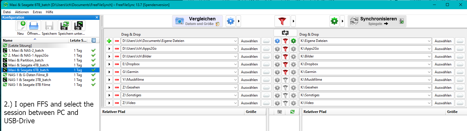

I have a folder on my PC "D:\Users\Ich\Documents\Eigene Dateien" and FFS should sync it with the folder "K:\Eigene Dateien", a USB Drive.
It should be it as an mirror, will say, all files which exist on "D:\Users\Ich\Documents\Eigene Dateien" should copied to "K:\Eigene Dateien". Files, which not exist on 'D' should be delted on 'K'.
But FFS don't copy the files and folders.
Any ideas? What is wrong?

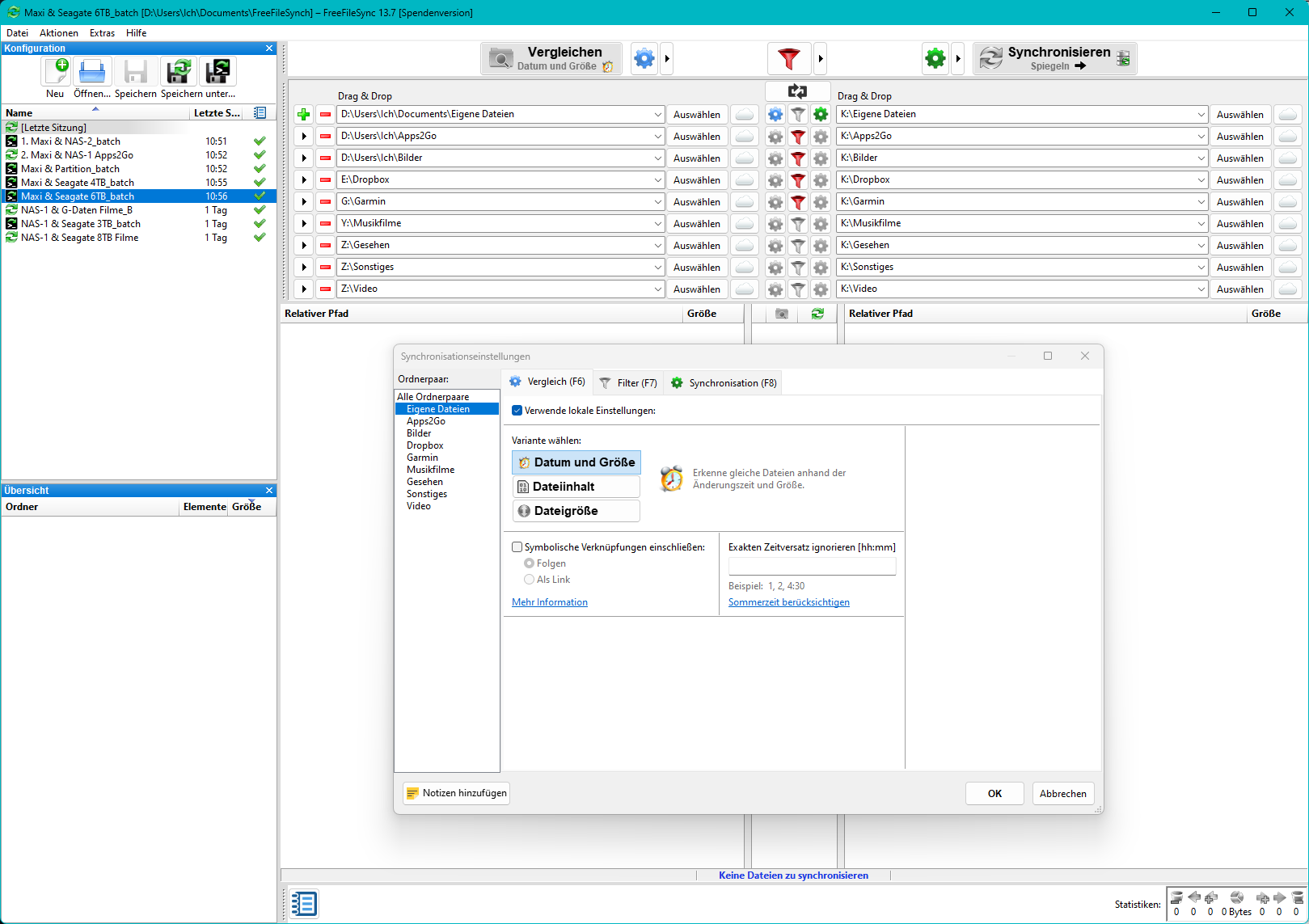

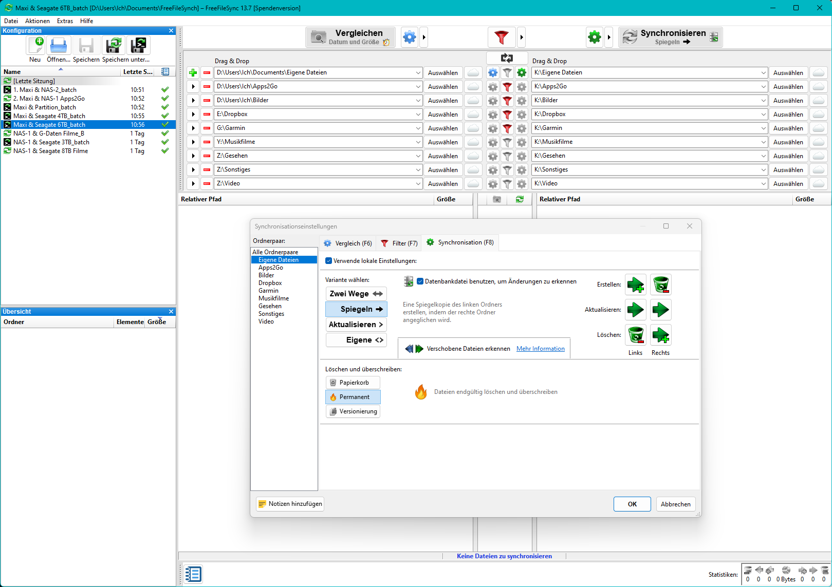

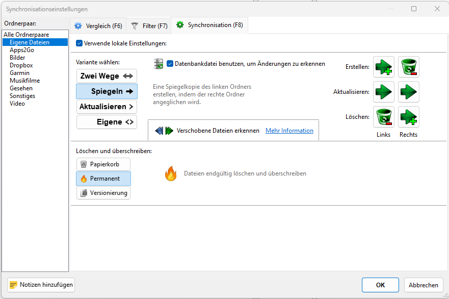

Screenshot of your comparison results?
What you describe, & your sync settings do look to be correct (to coincide with one another).
- Posts: 6
- Joined: 25 Jun 2024

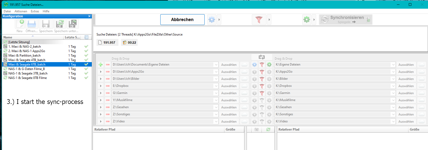

Thank you for your quick response. I have made any screenshots. I have created some screenshots, which can be found in the attachment. I hope, they are helpful.

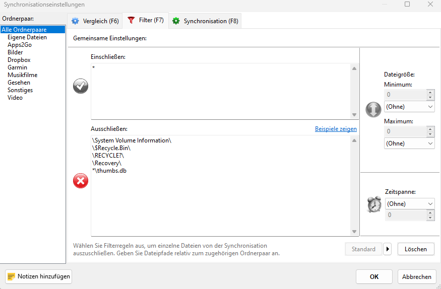

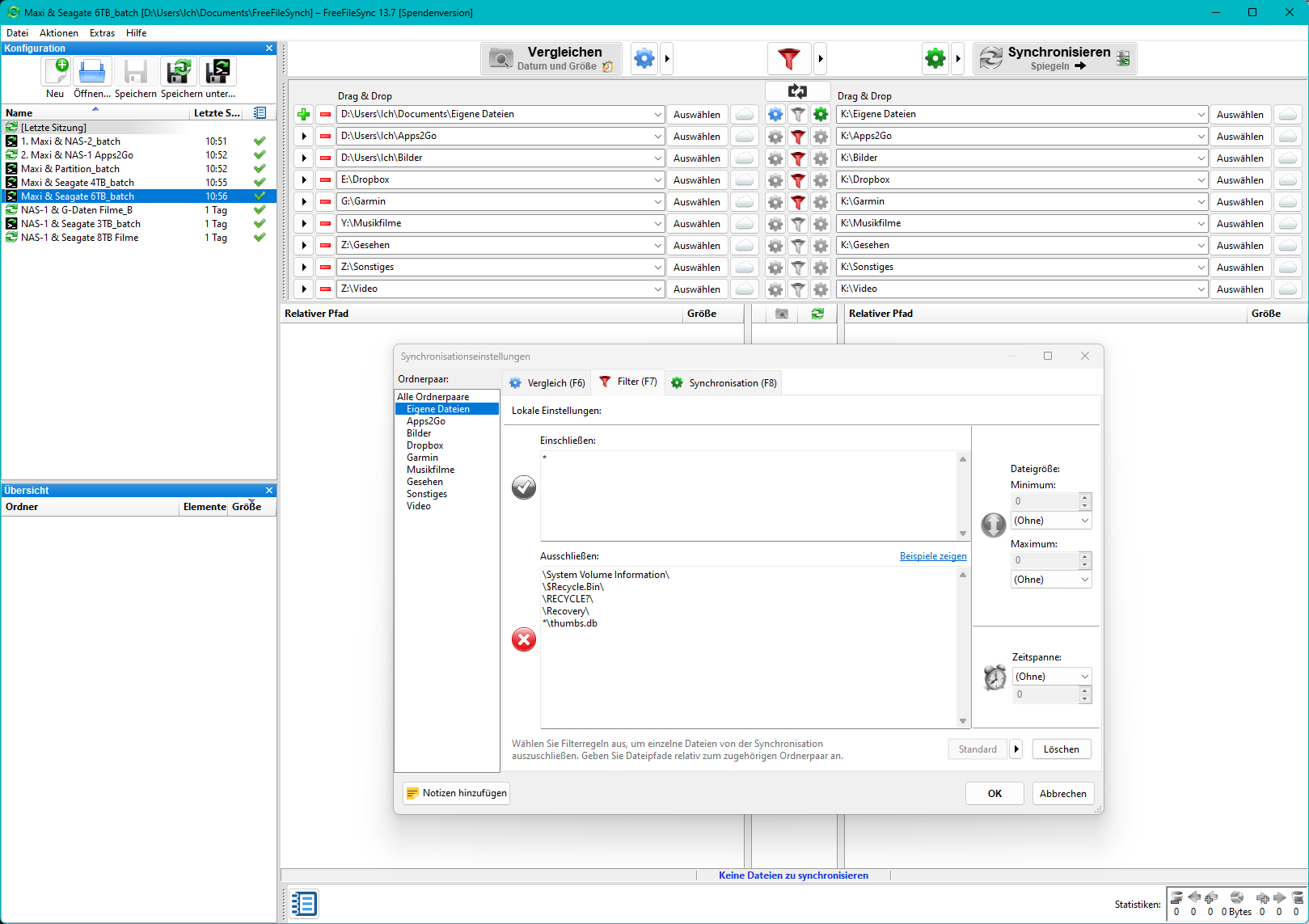

My guess would be a broken global filter (not shown in the screenshots).
- Posts: 6
Hi there!
There is no global filter set.

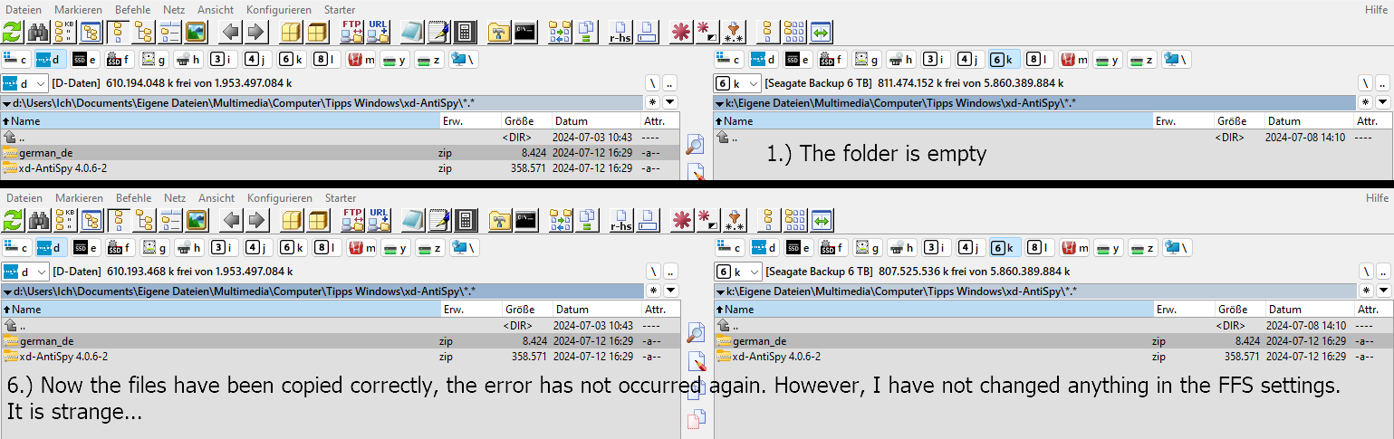

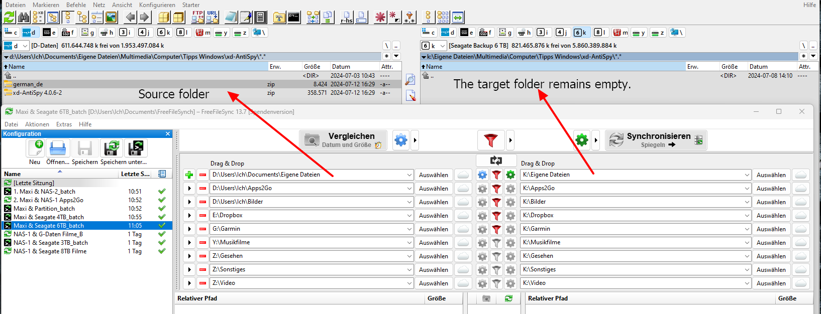

After the comparison, NO result is displayed, as if the source and destination were the same.
I have copied the missing files by hand, now the error has not been restored for the time being.
That is strange.
That is strange.
That's why I said to post screenshots, there would likely have been info we could have gathered to determine the issue. Manually copying the files probably didn't fix anything. As Zenju said, likely a filter or path issue#xCSxXenon

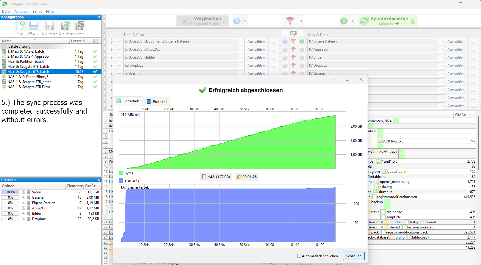

Today I have tested it again, It works, for whatever reason.
I Have posted the last screenshots.
I think it's done. Thanks for all the help and support!
