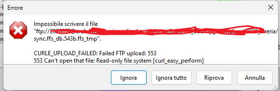

Good morning,
When I attempt to synchronise folders from a read-only FTP source, the content is copied but I receive an error at the end of the process.
Can anyone tell me how to solve this problem?
Posts: 4933
Disable using a database to track moved/renamed files for this configuration

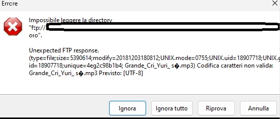

new error :(

Posts: 4933
Thank you 1000, it works now :)
I take advantage of your expertise for another question...
Is there any way to set the created copy to keep the creation and modification date of the original file instead of putting the date of the day of the copy? Enigmisth, 21 Jul 2024, 17:42
This is a limitation of FTP, not FFS
The error you are seeing is most likely an issue with the FTP server. Can it be updated?

I have no idea, it is an old Aruba linux hosting but before touching it I would prefer to have a full backup.
So I have to rename all those files correct?
While for the date change problem I have to switch to SFTP?
have I understood correctly?

So I have to rename all those files correct? Enigmisth, 21 Jul 2024, 18:13
If that is sufficient for you
While for the date change problem I have to switch to SFTP? Enigmisth, 21 Jul 2024, 18:13
SFTP is still FTP, so no. You just don't get to keep timestamps AFAIK

are all accented characters

there were about 20 of them, I renamed them, they were all accented letters

The accented letters likely aren't in the UTF-8 format, so that would make sense
