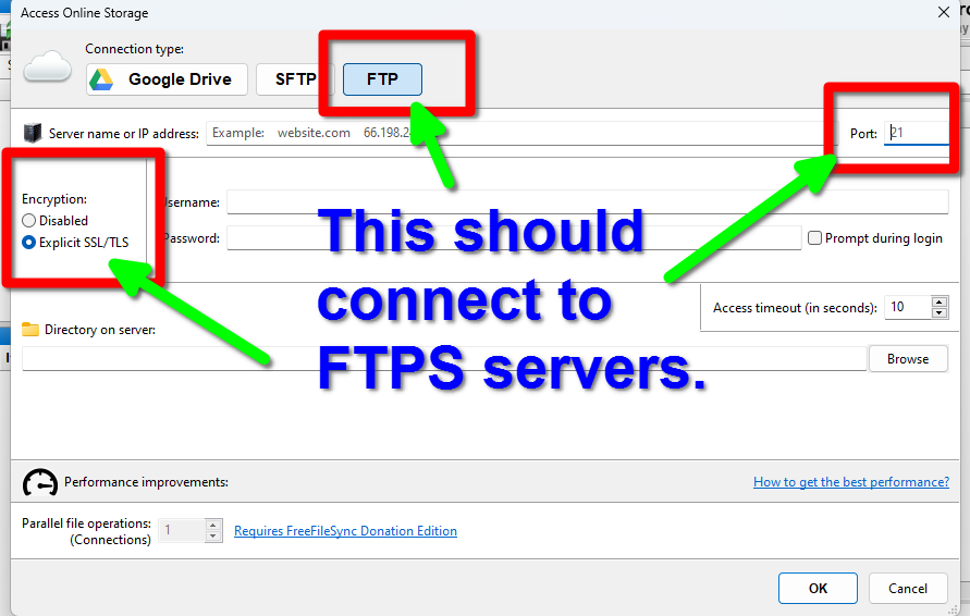

Follow this picture and you'll have FTPS.

Thanks for the information, but it doesn't work for me. With those settings, I get a successful connection to the root of *a* server / site, but it isn't the FTPS site I end up at when connecting with FileZilla. I get an error:
Cannot read file attributes of "ftp://username@host/username".
"username" does not exist.
If I try connecting with FileZilla using plain FTP with my credentials, it connects to the same URL, DOES see that folder, but the contents of that folder are different than if I connect with FTPS.
- Joined: 31 Aug 2024
The only (apparent) difference is the use of ftps:// instead of ftp:// in the URL.
