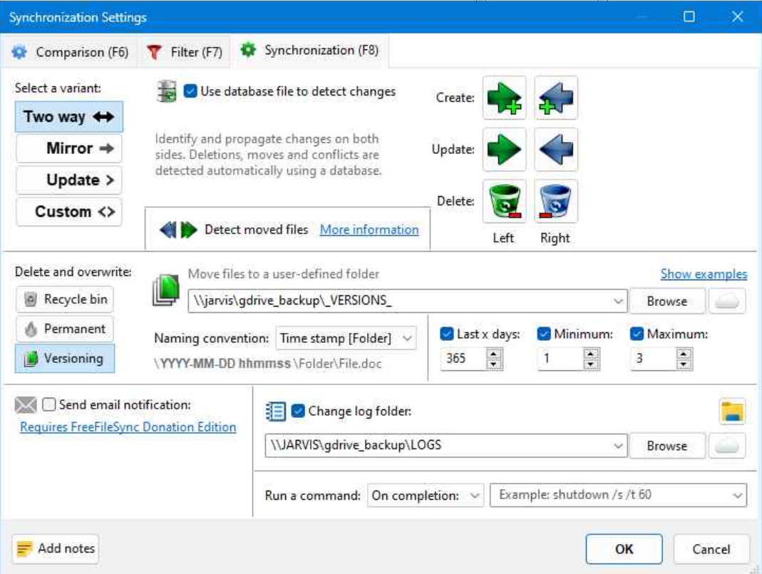

I am just starting out to use FFS, and so far, it has closed a gap I had with syncing Google drive to a local NAS. I do eventually want to look at getting it setup in a docker container, but until then, I wanted to see about an issue I am seeing with the Versioning feature.
I have a Batch Job setup to run on a Windows machine to do a 2-way sync with Google Drive and a network share (NAS). I have been reviewing the logs regularly since I am still new at using the tool and want to make sure I am not messing something up. On Delete Files, I have setup Versioning with Folder Timestamps. I have also set to retain Max 5 copies. This worked fine for the first couple of days, but now that the time has passed with changed files, I am starting to see the logs fill with errors.
Specifically, I am getting this error:
8:02:22 AM    Error:    Cannot delete file "\\jarvis\gdrive_backup\_VERSIONS_\2024-09-03 080002\BACKUPS\UNRAID\APPDATA\ab_20240721_050002\VPN.tar.gz".
ERROR_FILE_NOT_FOUND: The system cannot find the file specified. [DeleteFile]
This same error is repeated a few times, which I thought was interesting. I started looking, and something stuck out as odd. This did not seem to be an issue of creating the copies of the file when it detects a change or deletion, but rather, its attempt to clean up old copies that conform to the Max Days, Minimum and Maximum numbers to keep. The file it was attempting to delete did not exist. I then realized the path was using the date it batch job runs as the Folder Date instead of the date at which the version was created (or the log message is).
Might just be me, but I think this is a bug.
Posts: 4945
What is your versioning location set to in the settings?

What is your versioning location set to in the settings? xCSxXenon, 03 Sep 2024, 14:27
Here are my settings:
Posts: 4945
@Zenju
This only correlation here seems to be Gdrive access. I can't imagine how that causes FFS to behave any differently than using just local drives, but I would then expect that this would be an issue for every single user using versioning, which also doesn't seem to be the case. I would wait for the dev to chime in, I don't think this is something an end user can remedy.

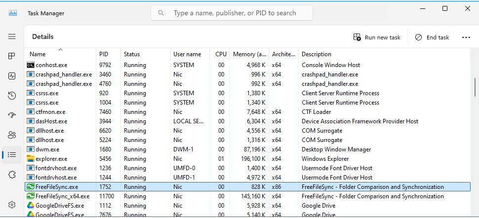

So I have this running through a Batch script so I can capture some custom logs on versions, times, etc... Here is the code:
@ECHO OFF
SET SCRIPT_VERSION=1.1
ECHO [%DATE:~10,4%-%DATE:~4,2%-%DATE:~7,2% %TIME:~0,8%] Starting %~nx0, Version %SCRIPT_VERSION% >> "%~dp0log.txt"
"C:\Program Files\FreeFileSync\FreeFileSync.exe" "%~dp0Google Drive - Cloud Sync.ffs_batch"
ECHO [%DATE:~10,4%-%DATE:~4,2%-%DATE:~7,2% %TIME:~0,8%] %~nx0 complete. >> "%~dp0log.txt"
Now, when this runs, I get 2 processes running, and I don't know why, but it does based on the command line argument from the above batch script. When the job finishes, both processes disappear. Is this normal? Should I be calling the x64 executable directly instead? Also, if it was 2 processes overlapping, wouldn't I also get 2 reports generated too? In this case, I do not.
I have the job run every 2 hours (Windows Task Scheduler), and it finished each time in 9-10 minutes, so it shouldn't be overlapping processes.
Posts: 1246
Joined: 8 May 2006
therube
FreeFileSync.exe is simply a "stub" whose only purpose is to call either FreeFileSync_x64.exe or FreeFileSync_Win32.exe (depending on circumstances).
So that you are seeing 2 "FreeFileSync .exe" is normal & expected.
