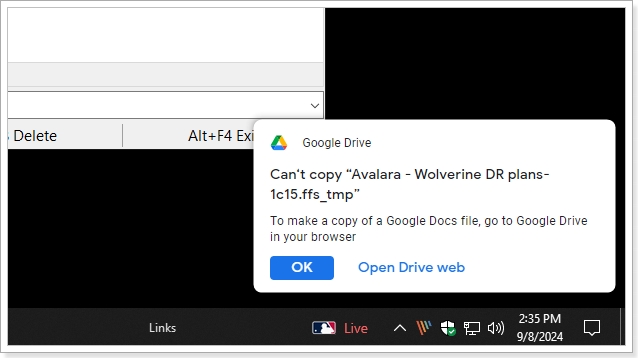

Can someone tell me what this error is and how to address it?
Do these errors cause the Sync to stop running.
When I run the ffs_batch file - I get about 20 of these notifications.
Google Error when sync underway

You should use the native Google Drive integration. This is because FFS creates a copy of the file with .ffs_tmp extension first, this ensures data integrity. Once the transfer is completed, it will be renamed to the correct name. Your Google Drive client is trying to sync that tmp file but likely doesn't finish before it disappears.
