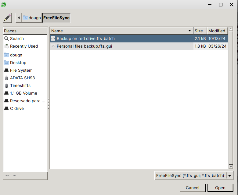

I click on "File - Open" and I get this dialogue:
The selected file is the one I want. I click on "Open" and nothing happens. What do I need to do differently?

- Posts: 2997
That is very strange. You should be able to open any selected *.ffs_gui and *.ffs_batch sync configuration in the FFS GUI.
Obviously, if the selected *.ffs_batch file is already open and is the active sync configuration in the FFS GUI, your "Open" window will close/disappear, and you will return to the main FFS GUI with the selected sync config (still) active. Then it may seem "nothing happens".
Nevertheless, it seems the part I could potentially help you with (AutoClose="false") is already OK.
The problem may then be related/specific to Feren OS, which I am not familiar with.

Yes, your explanation is correct. I was starting with the file open in the GUI, so I just needed to do the next steps that you outlined for me.> That is very strange. You should be able to open any selected *.ffs_gui and *.ffs_batch sync configuration in the FFS GUI.
Obviously, if the selected *.ffs_batch file is already open and is the active sync configuration in the FFS GUI, your "Open" window will close/disappear, and you will return to the main FFS GUI with the selected sync config (still) active. Then it may seem "nothing happens". Plerry, 24 Oct 2024, 07:02
