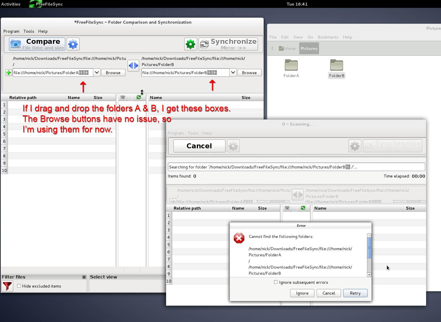

With regard to a new clean install of: Linux 7.0 Debian Gnome AMD64
I've seen a few other posts about the (Cannot find folders) error that fell to the bottom of the list here and none of the answers resolved the issue.
However I want to mention that if I use the "browse button" to link up the folders rather then just dragging and dropping the folders into the path, there are no issues at all.
If nothing else, I would like to understand what this error is caused from? There are two little square boxes that show up at the end of the path field also. I've even tried syncing two basic folders with simple names: 1, and 2. The browse button works just fine. Though the drag and drop would be eraser.

Not sure if I understand the problem: Some directories are found with FFS if you select them via "Browse" but they are not found when you drag and drop them onto the main dialog?
- Posts: 12
- Joined: 26 Mar 2013
Hello Zenju,
The browse button works on all directories.
The drag and drop function doesn't work for anything.
I get an error no matter what folders I try to drag. The error happens when I click the compare button. By the way, Folders A & B are both empty, but it doesn't matter. The error happens on any folders I try to drag. Again, I'm using the browse button(s) with no issues at all.
Please see attachment.
Or use this link - Removing hxxp
hxxp://www.pyramid-of-wisdom.com/ffs_error.jpg

I see what you mean now. wxWidgets unhelpfully passes file and directory drag and drops unformatted as URI strings. For the directory input fields this doesn't make sense and isn't needed anyway. Luckily I found a way to deactivate these drop operations in GTK. The next FFS version will behave as expected (but doesn't support text drag and drop anymore, which shouldn't be a big loss).

Nice work on this last version (5.22) Zenju!
This fixed the URI drag and drop issue for me on Linux. Much appreciated!
