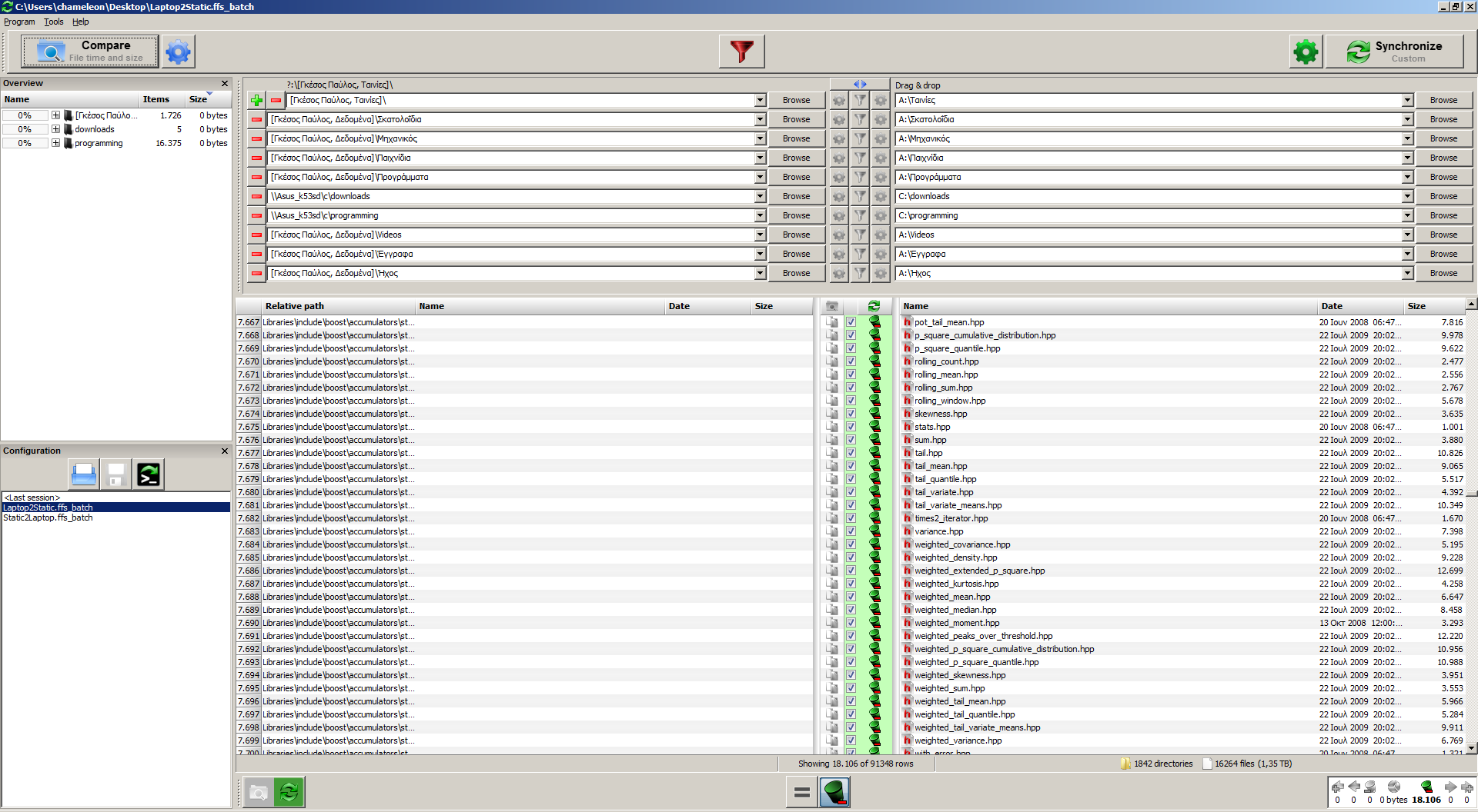

I believe the same, but seems to be a problem.
I attach 2 screenshots of my 6.2 version (6.12 does the same thing).
This problem is caught at a later stage: if you try to start sync you'll get the error "source folder not found".
