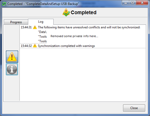

- Posts: 26
- Joined: 19 Oct 2009
That would be nice, but unfortunately I can't see such a possibility to switch to GUI.
I'm using version 7.1 of FFS and call it like this:
FreeFileSync.exe myjob.ffs_batch
In the configuration I don't supress the popups.
Please see the attached screenshots.
Hopefully I didn't misunderstand anything.

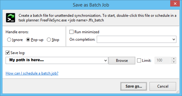

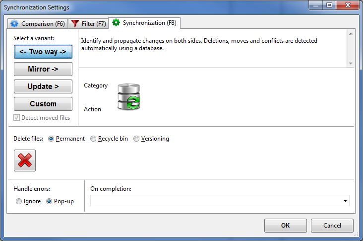

- Posts: 7567
What are your settings in the "save as ffs_batch" dialog?That would be nice, but unfortunately I can't see such a possibility to switch to GUI.
Hopefully I didn't misunderstand anything.echtatze
- Posts: 26
In the ".ffs_batch" file I couldn't find anything regarding 'saving', so I loaded it by hand and called "save as ffs_batch", took care that "pop-up" is selected and saved it with a different file name.
After textually comparing those two ".ffs_batch" files (with Total Commander) there was no difference between them.
So the parameters you asked for look like the dialog in the attachment.
- Posts: 7567
The configuration so far looks correct. There is probably only a single reason left why the warning dialog is not shown in batch: you have selected the "don't show this dialog again" checkbox. This setting is saved in globalsettings.xml, but all warnings can also be restored via menu -> tools -> options.In the ".ffs_batch" file I couldn't find anything regarding 'saving', so I loaded it by hand and called "save as ffs_batch", took care that "pop-up" is selected and saved it with a different file name.
So the parameters you asked for look like the dialog in the attachment.echtatze
- Posts: 26
You are right, I took a look and saw that "WarnUnresolvedConflicts" is set to "false".
So I set it to "true" and finally there is the mentioned dialog!
So far so good.
But when I now press the "Switch" button in this dialog, the gui starts up and then there also is no logging to file any more. :-(
Any idea?
Maybe better implement logging in gui mode yet?
So far so good.
Any idea?
- Posts: 7567
The idea for GUI mode is that since the user is handling synchronization manually, he will also acknowledge the results dialog showing a (non-persistent) log. In addition there is %appdata%\FreeFileSync\LastSyncs.log.You are right, I took a look and saw that "WarnUnresolvedConflicts" is set to "false".
So far so good.
Any idea?
Maybe better implement logging in gui mode yet?echtatze
