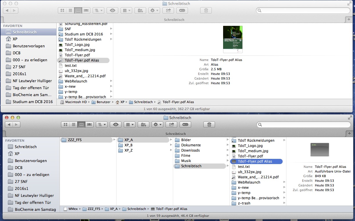

Dear Zenju, I skipped a few updates, but yesterday a switched from FFS 7.1 to FFS 8.3 on a Mac OSX 10.9 (Mavericks). Now the Mac Aliases Problem is back again: While for FFS 7.1 aliases created new it worked fine, synchronizing with FFS 8.3 will produce non-functioning aliases on the destination drive, see screenshot. I would really appreciate it if you could fix this bug for the new version. Or shall I switch back to FFS 7.1 again?

Yes, FFS7.9 works also fine, but FFS8.0 creates non-functioning aliases on my destination drive which has extendedFAT format.
I have also tested a destination drive with "Mac OS Extended Journaled" format, there FFS8.0 works fine. But I prefer ExFAT as destination drive format, because I want to have read/write access to the destination drive on a Windows computer. Therefore I would be really grateful if you could make it work also with ExFAT drives.
