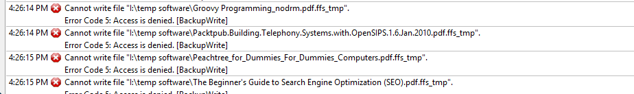

I have the same error. I'm also using windows 10. I'm syncing to an external USB 2 drive, I've set all users with full permissions to this drive. and I've tried running FreeFileSync as administrator.
I'm including a graphic attachement with an example of the error, but I get 100's of this error.
thx for the help!
thx for the help!

Seems to be the same as viewtopic.php?t=4107I'm including a graphic attachement with an example of the error, but I get 100's of this error. cruzmiester, 15 Feb 2017, 15:55
