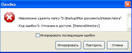

On one of the computers where I use FreeFileSync, when I synchronize the Desktop and Documents folders with their copies located in the D:\Backup\ folder, an access error occurs whenever FreeFileSync try to delete unnecessary files or folders. For example:
OS on it is Windows XP Home SP3.
Permissions for folders in Windows XP are not regulated (with the exception of "Documents and Settings" subfolders). Programs that can block access to D:\Backup\*. * seem to be absent. Deleting the files and folders specified in the FFS error messages by the Total Commander also impossible. However, if I log on to Windows as a user with administrator rights, then these files and folders can be deleted normally.
I have also a copy of the problem synchronization task, differing only in that the backup is not located on a local disk, but in a network folder. This task is executed without errors.
Testing and fixing the file structure of the disk performed, the antivirus disconnected - does not help. Are there ideas, how to determine the source of the problem?
