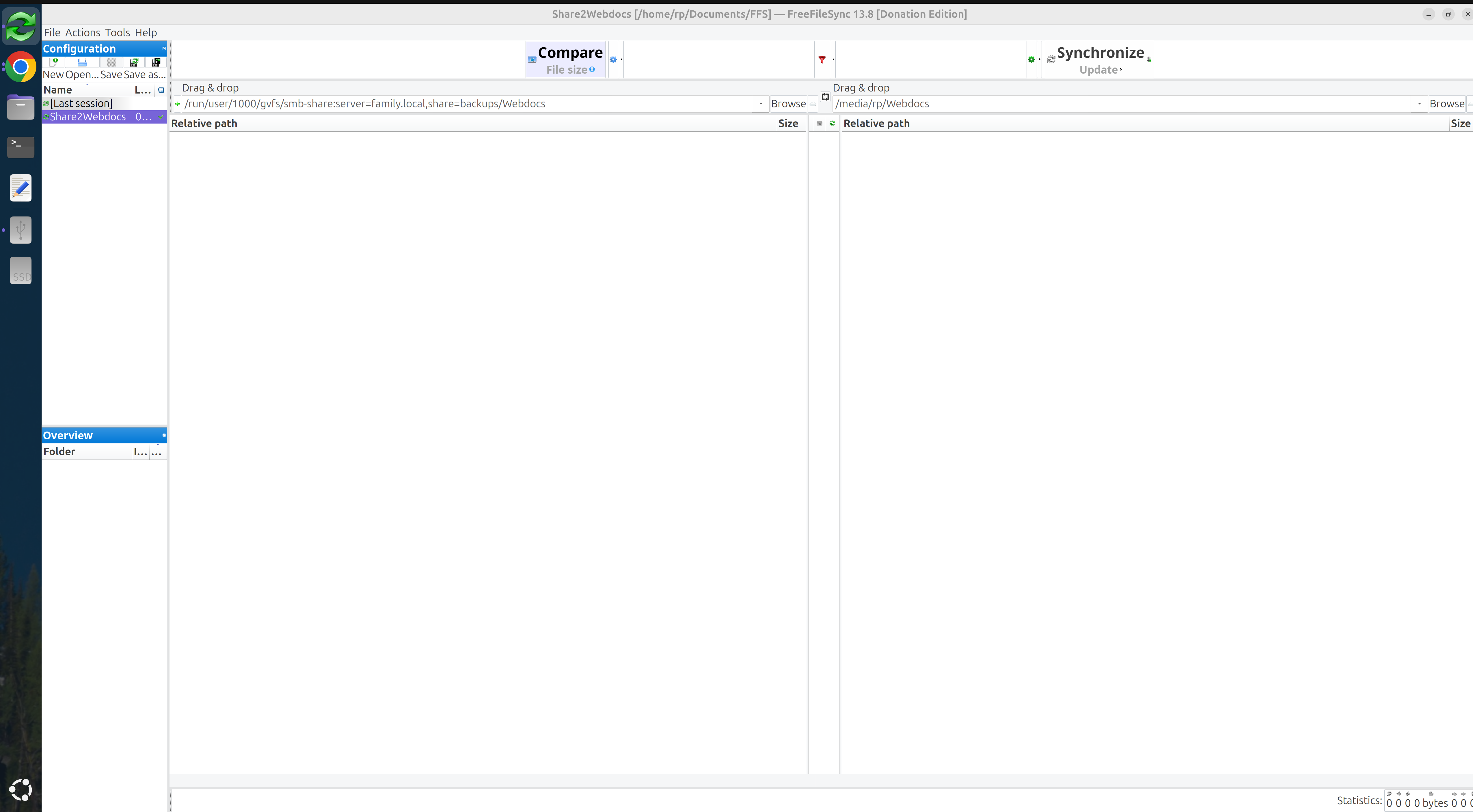

- Posts: 5
- Joined: 27 Oct 2024
Is there a resolution for this problem? I'm using Ubuntu 24.04. I like the interface of FFS quite a bit, but on a 4K screen with 150% fractional scaling, the icons are very small and it makes FFS harder to use. I'm a newbie to Linux, apologizing in advance if the solution is something I should already know.
