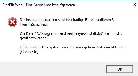

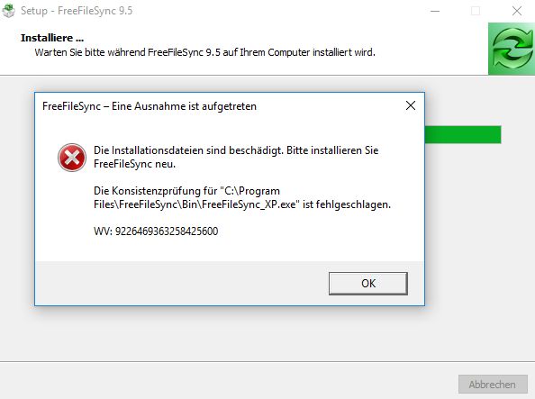

I've used FFS Free until yesterday, when I updated from 9.1 to 9.5.
I received the following error:
A later start brings:
I've disabled the AVG Antivirus while the setup, but the error is the same.
Setup an old V9.4: Same problem.
And also my old setupfile V9.1, that works until the update yesterday, now shows the same error !
Whats wrong ?

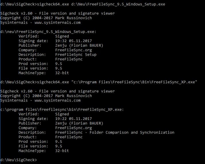

Can you check the signatures of the installer exe as well as FreeFileSync_XP.exe and see if they are valid?

SigCheck from SysInternals ?
Why is "FreeFileSync_XP.exe" used and not "x64" on Windows 10 x64 ?
You simply could have right-clicked in Explorer, but sigcheck is fine. The signatures seem to be broken in your screenshots: They are not "verified" and do not show a "publisher".
Maybe the installer really *is* corrupt due to a download error? Can you post a checksum of the installer (whatever you can generate).

Moment... again with SigCheck64:
MD5 (from TotalCommander):
7dea96ea31b15d099a343a47c2d48e21
I've downloaded the installer multiple and also from another location. All the same !
Interesting. Your 32-bit version of sigcheck fails to verify the signature, while the 64-bit one succeeds.
In my test, the 32-bit version of sigcheck also succeeds to verify. FreeFileSync_XP.exe is also a 32-bit executable.
7dea96ea31b15d099a343a47c2d48e21 is the correct checksum.

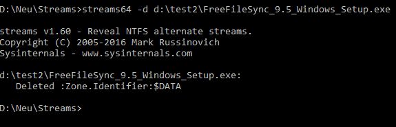

This could be worthwhile to check! Browsers have the tendency (especially IE) to add alternate data streams to downloaded executables in order to mark them as unsafe. Can you make a copy of the installer (= please preserve the test case) and then run "streams -d" on the copy (this is another Sysinternals tool) to remove the ADS.
Posts: 12
Joined: 29 Nov 2017
Micha_he
Here the results:
A test-setup with the copied file: Same result.

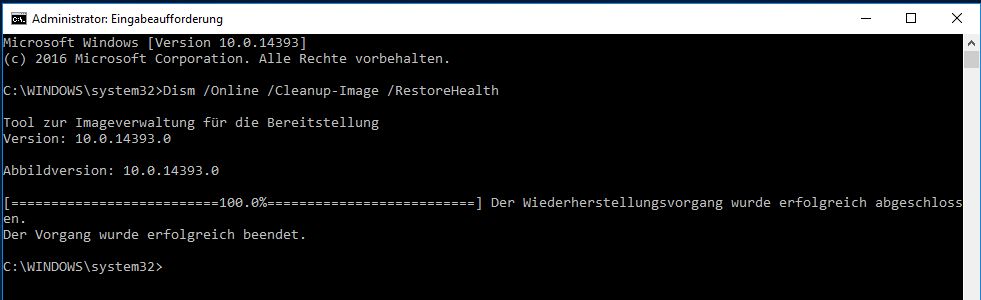

It may be a bit of a long shot, but I see no reason why the 32-bit sigcheck should fail, unless the OS is damaged in some way. It would be worthwhile to check it for errors (and repair them) via
Dism /Online /Cleanup-Image /RestoreHealth
Posts: 31
Joined: 26 Nov 2017
shai
Also, please try and download using another browser.
Posts: 12
Joined: 29 Nov 2017
Micha_he
...improbable (it works yesterday before update and no other application has any problem), but...
followed by a restart and....???....: Same !
