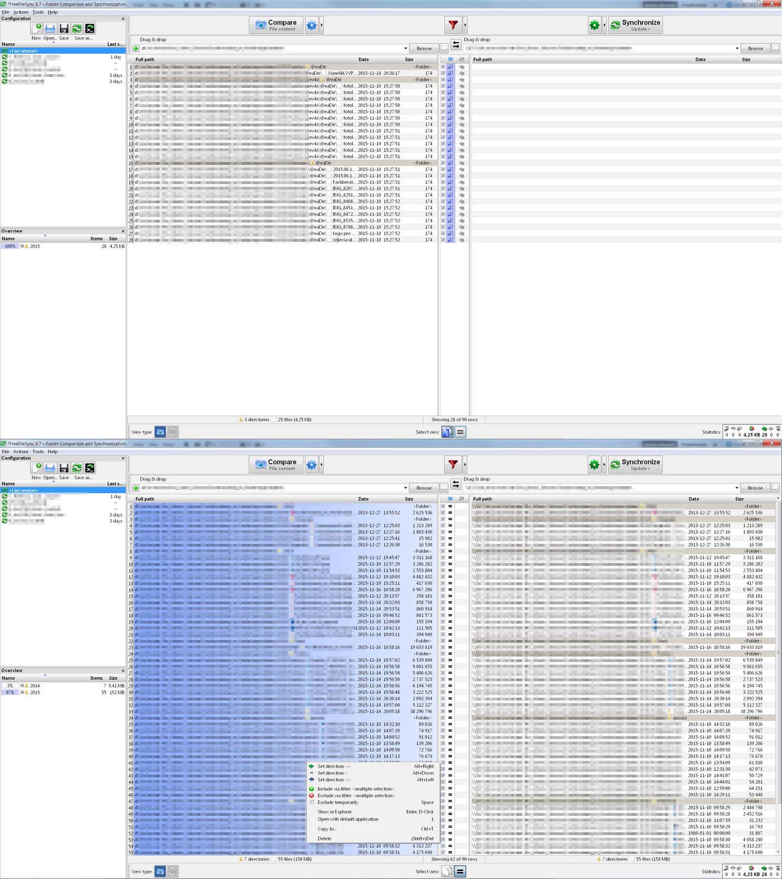

Pic_02: Showing only equal files and directories

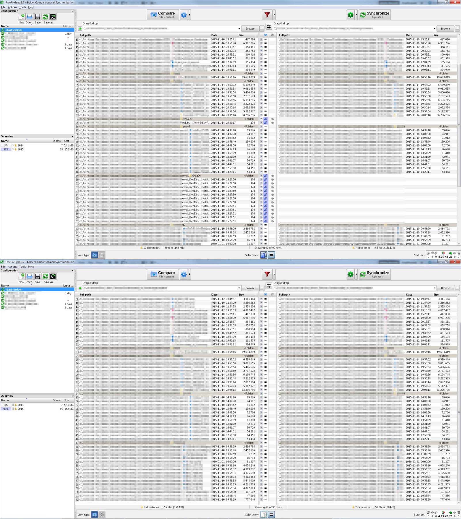

Pic_03: Showing only unique files on the old drive

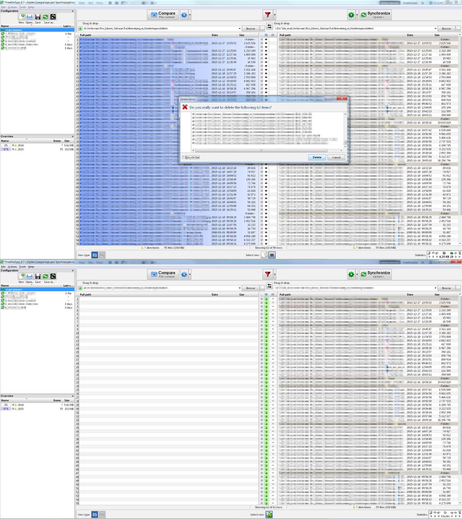

Pic_04: Showing only equal files and directories again, CTRL+A (select all), right click, click delete
Pic_05: I do not want the deleted files to go to the recycle bin (unselected it)
Pic_06: Ooops!! I end up wit _no_files_and_directories_ on the left side! I would expect to delete only the selected equal files...

The problem is you selected not only files, but also folders.

Hmmm... I actually made sure, that I did not have any folders within the "deletion window" (Pic_05), that would be the ones with the fancy "@" sign in the name, as you can see them in the picture 03...
Or, if I mark a folder, is it like "I marked this folder - delete the folder and all files and folders in it even if there are "not equal" files present in it?
How can I achieve, what I wanted (I hope I described it clear enough)?

You could set up a file size filter with a lower limit of 0 bytes (https://freefilesync.org/manual.php?topic=exclude-items) or simply sort by size or by date and only select the files.
