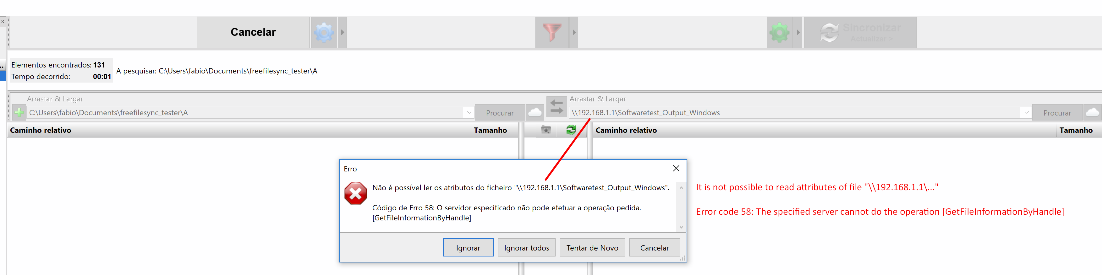

I have a smb server where I can access and read and write without problem, but when I try to use FFS with it through his IP, I receive the following error:
Do you know a way to solve this without having to map this unit with a letter in this system?
If you need more info, let me know.
Thanks!
Code error 58: GetFileInformationByHandle

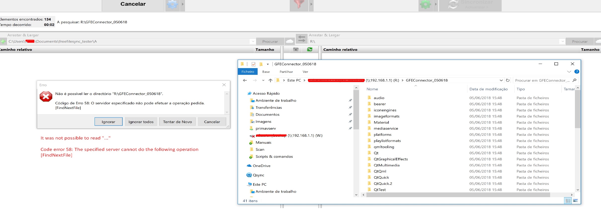

Using the direct link for example \\192.168.1.1\shared_folder I am able to sync, but if I try to use it as a mapped unit, I receive that error.
If I have to use the direct link there is no problem. I have just started this thread just to let you know Zenju about this issue(dont know if is an issue with FFS or Windows).

Ofcourse Zenju.
With FFS 9.9 64bits:
Interesting, so this looks more like a (temporary?) server issue.
- Posts: 15
- Joined: 20 Sep 2017
Is a SMB server working in Server App 3 on a MacOS.
Using native explorer I dont have any issues at all, but using FFS I receive those errors.
In times I have found similar problems with xcopy command line from windows, where was able to copy some files and then received an error related with: the specified server cannot do the following operation. I have not found a relation with this error or some type of files or issues with folders or permissions.
