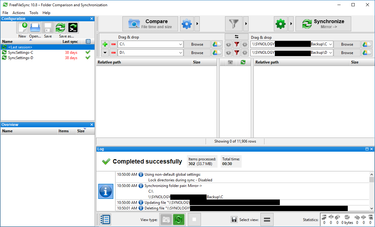

- Posts: 21
- Joined: 5 Oct 2018
A small quirk still present in v10.8. When two (or more?) configurations are run at the same time, the Last Sync values are not updated. When each config is run by itself Last Sync is updated. See attached screenshot of a just-completed backup. Prior backup was done about a week ago, yet after this new backup, Last Sync shows 38 days for both configs.
- FFS-last-backup-not-updated.png (93.98 KiB) Viewed 8424 times
