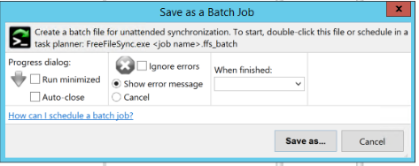

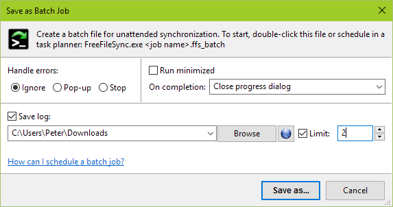

This setting is awesome to have here, but we used to have it on a per-session setting. So when you wanted to change the logs to point to the same folder as the backup, you would only have to worry about it keeping X number of log files. This got removed and I am not sure why. It is the setting when you save the batch job.
Before:
After:
