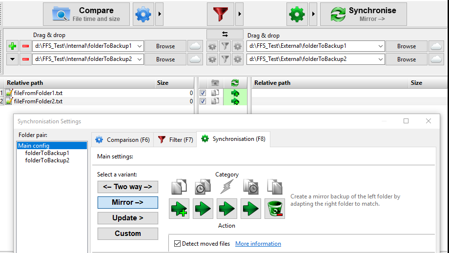

I want to backup 2 folders from internal storage, but without 1 unwanted one (a real-life example is using the whole D drive with multiple wanted and unwanted folders)
To achieve this I've prepared a configuration like in attachment:
2018-12-22 12_43_26-_FreeFileSync 10.7 – Folder Comparison and Synchronisation.png
2018-12-22 12_43_26-_FreeFileSync 10.7 – Folder Comparison and Synchronisation.png (58.65 KiB) Viewed 3343 times
Most important ones are "Mirror" + "Detect moved files". After synchronization file structure looks like this:

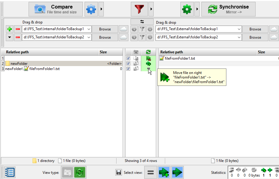

Now if I move
Internal\folderToBackup1\fileFromFolder1.txt -> Internal\folderToBackup1\newFolder\fileFromFolder1.txt
Then it is properly detected:

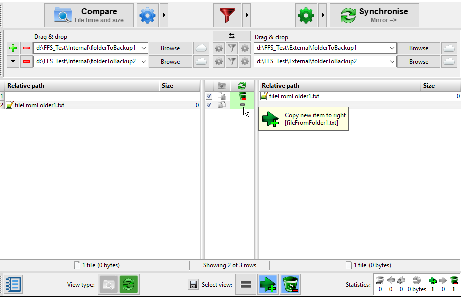

But if I'll (instead of moving above) move file like this (so between two folders and also between two "synchronization lines/folders" in FreeFileSync):
Internal\folderToBackup1\fileFromFolder1.txt -> Internal\folderToBackup2\fileFromFolder1.txt
With file structure like this:
Internal
├── folderToBackup1
│   └── sync.ffs_db
├── folderToBackup2
│   ├── fileFromFolder1.txt
│   ├── fileFromFolder2.txt
│   └── sync.ffs_db
└── folderToNotBackup1
    └── fileFromFolderToNotBackup1.txt
Then file move is not properly detected and I'm getting 1x remove and 1x copy (which is not a problem for small files but imagine a few 5GB files being unnecessarily copied instead of internally renamed/moved):
2018-12-22 12_55_09-_FreeFileSync 10.7 – Folder Comparison and Synchronisation.png
2018-12-22 12_55_09-_FreeFileSync 10.7 – Folder Comparison and Synchronisation.png (52.81 KiB) Viewed 3343 times
I expect that if the files are equal, so they have the same time and size (like selected in "Comparison (F6)" tab) then they shouldn't be copied and should be moved internally instead.
