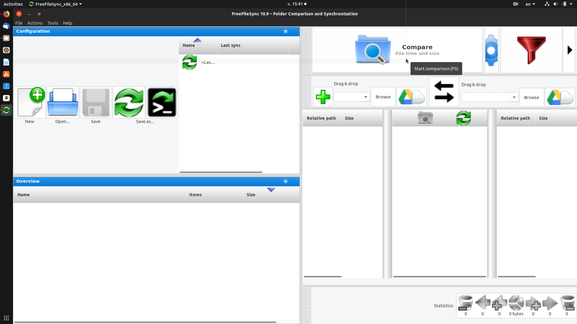

I used Ubuntu 18.10 and installed FreeFileSync for sync data when I installed and run FreeFileSync, it has problems as shown in the image file. Who can help me?
This is related to high-DPI settings. Do you have any steps on how to reproduce this?
Joined: 11 Feb 2019
pijag
This is related to high-DPI settings. Do you have any steps on how to reproduce this? Zenju, 11 Feb 2019, 09:42
I do not have any steps, can you recommend me the reproduce this?
Ideally, there would be steps that can be reproduced for Ubuntu 10.8 running in a VM, e.g. specific display settings, or whatever is triggering the above 288 DPI icons.

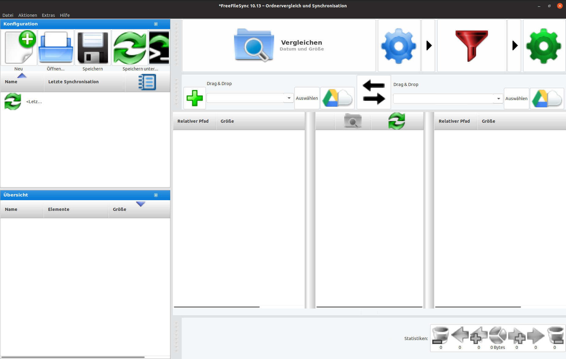

Joined: 5 Jul 2019
martin1
I have the same problem. It happens right after installation. I installed FreeFileSync 10.13 on Ubuntu 19.04.
Therefore the steps are:
Download 10.13
unpack the archive
double click the executable FreeFileSync
the same happens if I start it with ./FreeFileSync via commandline. In this case I get this messages:
Gtk-Message: 01:08:06.804: Failed to load module "canberra-gtk-module"
(FreeFileSync_x86_64:16001): Gtk-CRITICAL **: 01:08:06.984: IA__gtk_widget_set_size_request: assertion 'width >= -1' failed
FreeFileSync_x86_64:16647): Gtk-CRITICAL **: 01:13:35.034: IA__gtk_widget_set_size_request: assertion 'width >= -1' failed
(The second message appears twice.)
Installing the missing module with
sudo apt-get install libcanberra-gtk-module
does not solve the problem, but removes the first line of the error messages. the two Gtk-CRITICAL still appear.
I have 2 screens. One is set to 1920 x 1200 (16:10) and one is 1920:1080 (16:10). The error appears on both screens.
