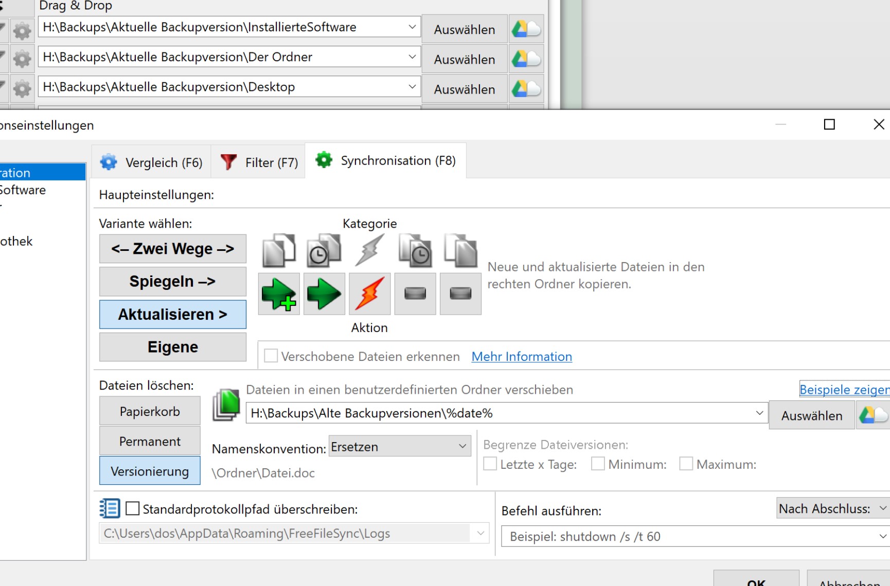

I'm using "3. Save versions at certain intervals" .
See:

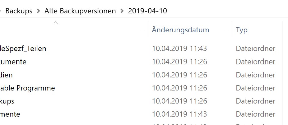

As you can also see at the top, I'm backing up more folders. Looking at an example versioning folder, you see this:
The problem now is that the first entry "...._Teilen" comes from e.g. InstalliereSoftware and "....umente" comes from e.g. "Der Ordner". So if i would have two backup resourceses which contain the same file which will be overwritten in the same backup, i would have a name conflict. So what would be needed that the folder isn't 2019-04-10/...Teilen and so on, it should be 2019-04-10/InstallierteSoftware/...Teilen and 2019-04-10/Der Ordner/...umente .
How to fix this?

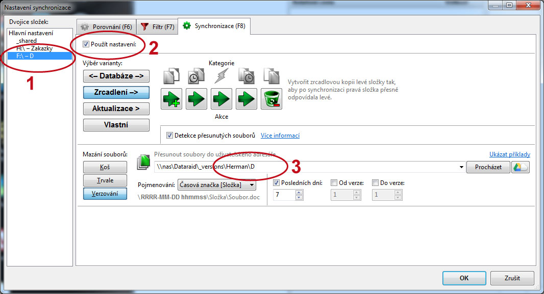

I had the same problem as you. The solution is to use individual settings for each backup job.
Sorry for my Czech interface, I believe the position of the elements is the same ... :)
