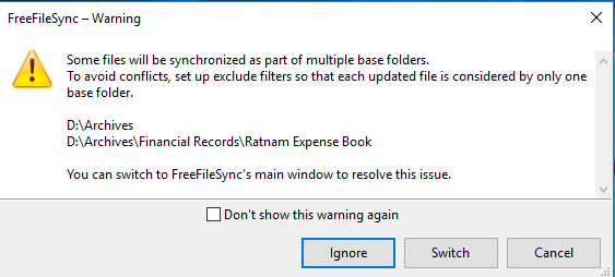

1. When I try to sync, I get a warning (attached) saying "Some files will be synchronized as part of multiple base folders. To avoid conflicts, setup exclude filters so that each updated file is considered by only one base folder".
The trouble is I don't want to exclude anything from the FIRST FOLDER PAIR as that acts as a full backup of 'Archives'.
I don't know what to exclude from the SECOND FOLDER PAIR. In it's Local Filter Settings, I did include this: \Financial Records\Ratnam Expense Book\* but the warning still came. If I ignore the warning (attached) it does sync. My questions is, am I doing something wrong OR should I ignore the warning? I think I'm missing something, hence, doing something wrong.

Multiple Base Folder Warning

If you want the Mirror sync to base folder E:\Archives to include everything from D:\Archives, including D:\Archives\Financial Records\Ratnam Expense Book, you should obviously not exclude anything.
This means there is an overlap with the second folder pair, so the warning is correct.
But, it is a warning , not an error. And with the sync as described, there does not seem to be anything "dangerous" related to this overlap.
The only limitation is as you describe under your item 2): the Compare action compares the left and right locations with their status prior to the sync. So, any changes to the overlap in location as a result of the sync are not part of the comparison and thus do not result in 2nd level actions.
The way to solve this, is by running a second Compare and Sync after the first one (as you describe), or by running two separate FFS syncs in sequence; first the Two-way sync for the second pair (which may results in changes in D:\Archives\Financial Records\Ratnam Expense Book) and then the Mirror sync for the first pair.
You can do this yourself from the FFS GUI, or by sequentially running the two separate FFS syncs from a *.bat or *.cmd script.
