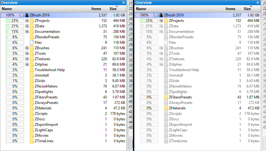

This is more of a feature suggestion, but:
It would be great if there was pair targeting for each individual pair. Currently when I right-click a folder I want, it adds it to the main config filter. Whereas I would like to target it to my 1st or 2nd folder pair filter:
RMB > Include via filter > Set01 > \folder\
It would be great if we could see folders that are set for syncing like in this image (On the right is clear: gray = not in my sync list)

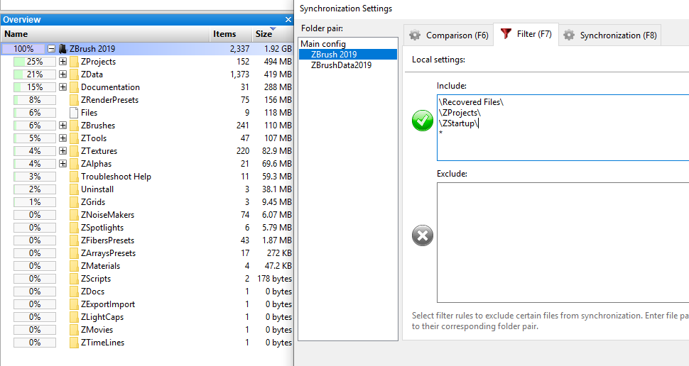

Ok, something strange seems to be happening here. I have 3 includes, only ZProjects is showing in the overview list on the left. But not ZStartup or Recovered files. Bug?

NB: Ignore the * in includes, i remove it when I'm done editing the list (otherwise nothing shows to add to the filter).
Posts: 3020
Adding the * on the new line in the Include filter makes the previous lines obsolete.
The * already tells FFS to include everything, so it already includes the folders listed just above.
The fact that, without the *, you get just empty folders is to be expected.
You have told FFS to include e.g. the folder \ZStartup\ , but not the files and subfolders in it.
If you want to also include the files and subfolders in those folders, as per my earlier reply, you need to change the Include filter definition from \ZStartup\ into \ZStartup\* (mind the * at the end).
