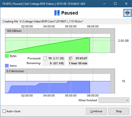

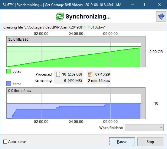

OK, I did another test and I paused the process at 4:32 PM today, at 5:06 PM the data was still transferring from the remote IP address as shown by resource monitor, I then took two screen shots one with it still paused then another a few seconds later after I continued the transfer.
You will notice that during the 34 minutes the transfer was paused the remaining amount changed from 681 MB to 499 MB, I think that pretty much proves that the transfer was still taking place.
If there is anything further that you would like to see, please let me know and I can provide it, I have many GB of files to transfer over this slow link and it is going to take days for it to completely transfer all the files.

The two pictures do show the same file being transferred. I'm guess whatever you are syncing from/to does not handle pausing in the middle very well, or at all. I don't think FFS just stops, I believe that it requests a stop and then waits for a signal to do so. I would try syncing those files between two local folders and see if it pauses normally. That will tell you if the program is glitching out or the remote volume.
