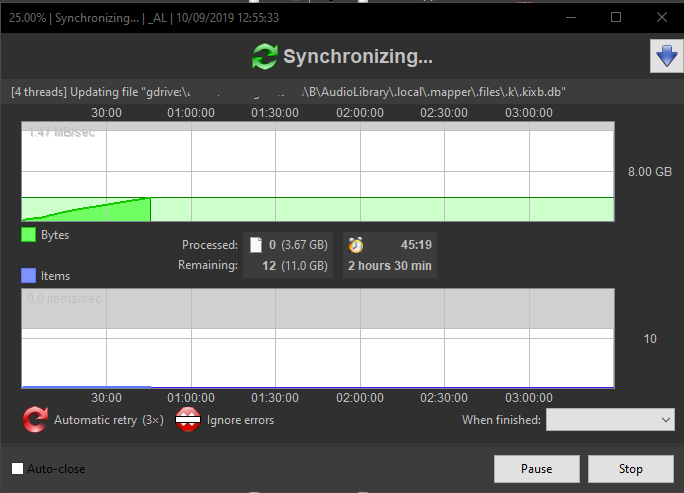

I've noticed, particularly with multi-threaded jobs, that the reported info about which file is being processed, the number of files processed so far and, by extension, the number of files remaining, either isn't correct or at the least appears to be misleading.
Here's one such example from a job which is currently running.
There are 4 threads in operation. The file FFS says it's uploading to Google Drive is .kixb.db which is a 400mb file.
But it also says that it's processed zero files in total and 3.67GB.

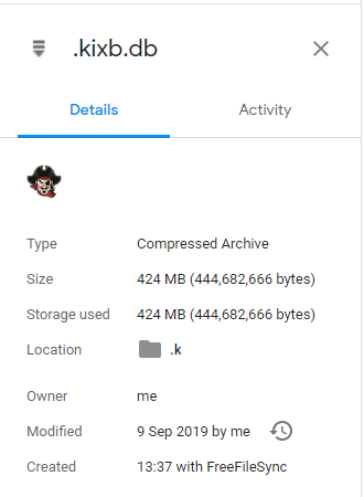

In actual fact, this file finished uploading a while ago...
...and FFS if now downloading an entirely different 1.67GB file.
There is still no accounting for where FFS gets its 3.67GB figure from - not in the live stats, at any rate.

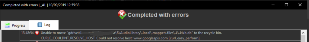

While I've been typing this, the job has timed-out downloading the 1.67GB file but FFS reports a non-existent error with the old .kixb.db file that was being replaced on GD which FFS says it was unable to move to Google Drive's recycle bin...

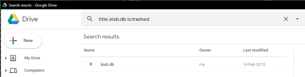

...and yet here it is quite happily sat in GD's bin...

The reporting is probably a consequence of "automatic retry (3x)", : e.g. copying a file failed => processed bytes increases, but not processed items.
