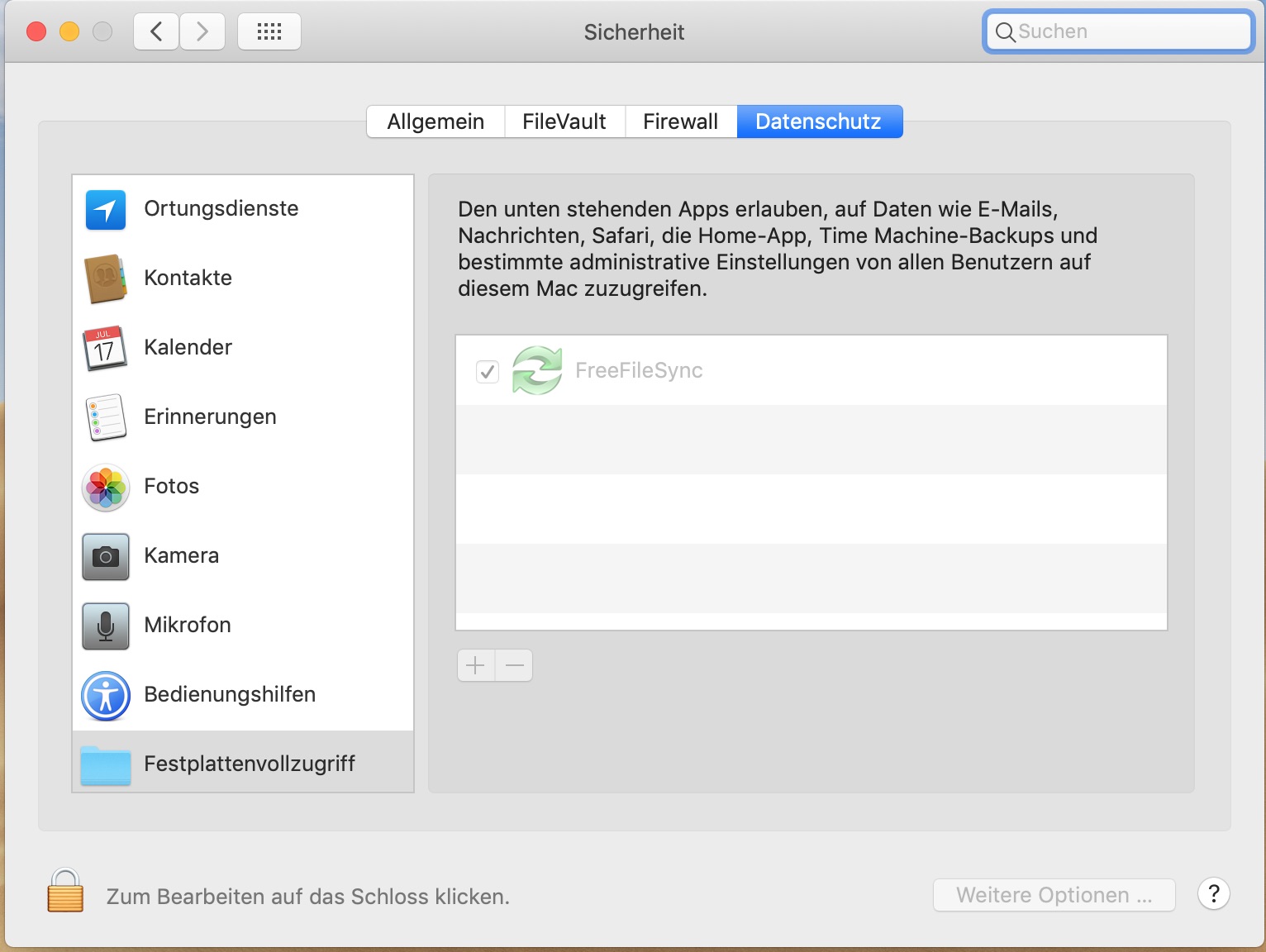

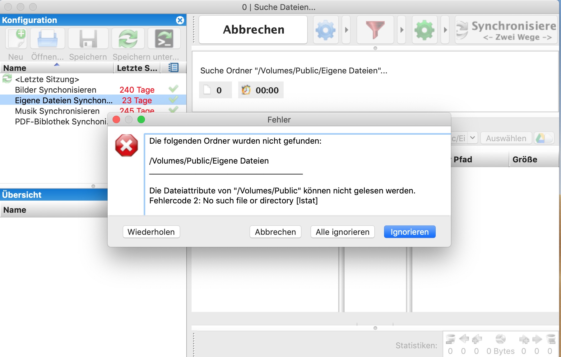

Since the last MacOS update to 10.14.6 I get the error code 2, the security settings I have adjusted according to the instructions. I do not know any more does anyone have an idea?
What does the command line show for "stat /Volumes/Public/Eigene\ Dateien" and "stat /Volumes/Public"?

Hello Zenju, thank you for your quick response. The result is "No such file or directory" This also solved the problem. The NAS did not reconnect after the update, which was different with past updates. Thanks again.
