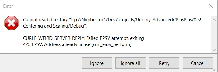

All the time I am getting error messages, see example screenshot in attachment,
"Cannot read directory "ftp://..."
CURLE_WEIRD_SERVER_REPLY: Failed EPSV attempt, exiting
425 EPSV: Address already in use [curl_easy_perform]
When I click "Retry" the process continues, but the error keeps popping up all the time...

The real issue seems to be "425 EPSV: Address already in use". As a consequence the FTP client tries to switch to PASV, but this isn't feasible for your IPv6 connection, hence "Failed EPSV attempt, exiting".

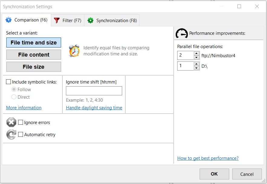

It is related to the number of parallel file operations; when I decrease that number, the problem becomes less frequent, only when I set it to 1 no problem anymore.

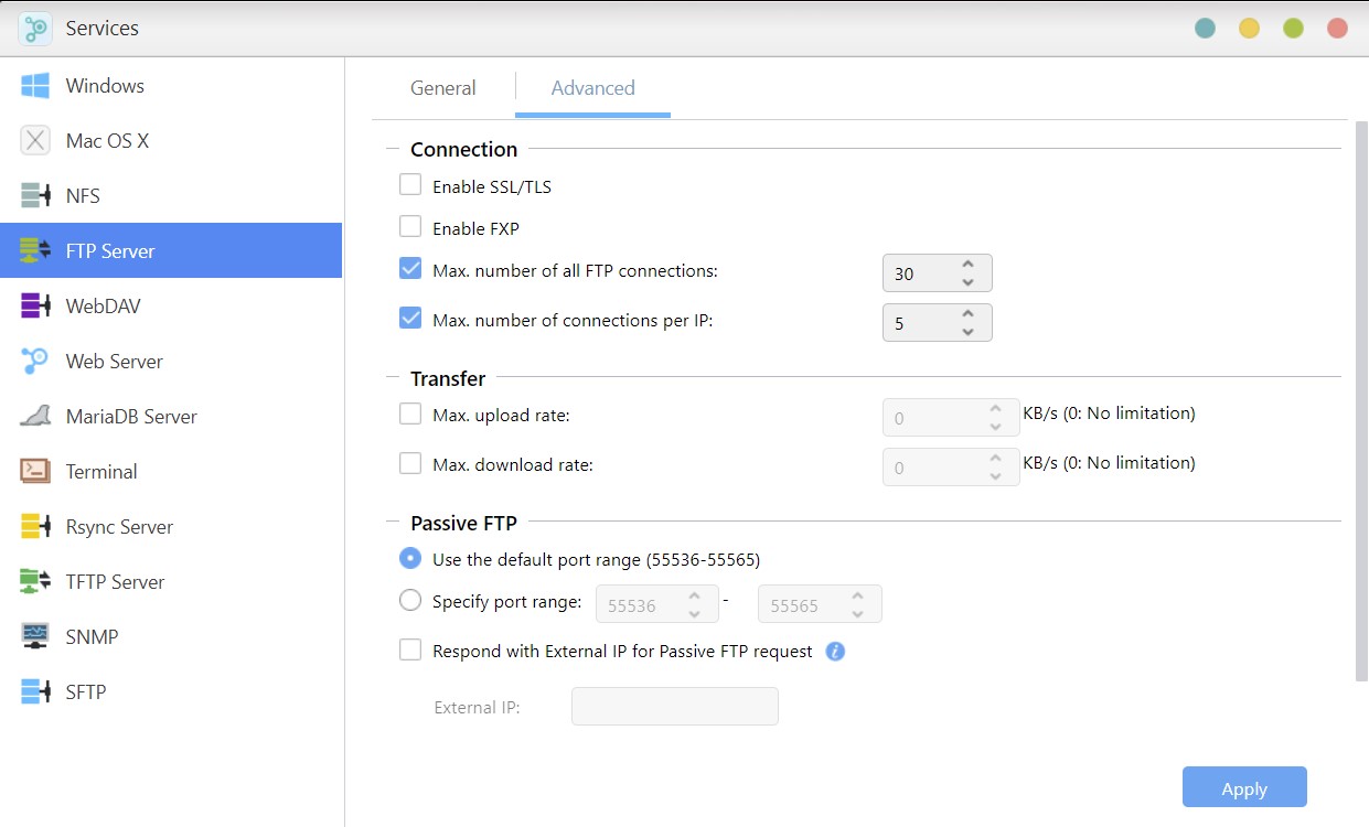

On the server side, settings are as follows, I assumed this is sufficient:

This looks like a fairly small range. Try increasing it, chances are, this fixes the intermittent errors above:
