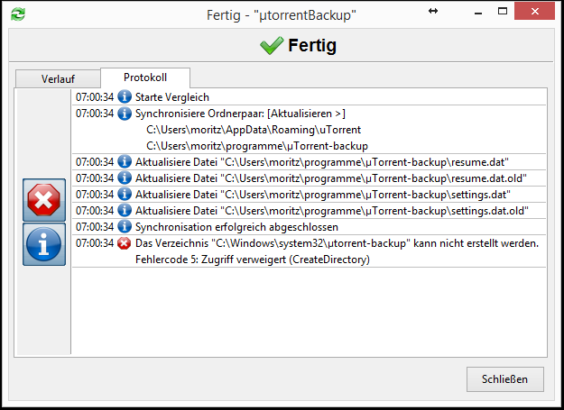

i fixed it in file. Is there a way to set log path in gui? Alternate solution would be to set execution folder in task planer.
For sake of completeness i added screenshot with error. This points also to logging problem because the error occurs after success.

the log file path and other setting are shown when you save as batchthanks!
For sake of completeness i added screenshot with error. This points also to logging problem because the error occurs after success.dermoritz
