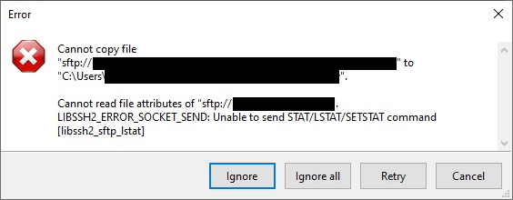

When i try to use SFTP synchronisation with a cloud, each time i have a file making more than 2Go to download or upload i get message :
"Cannot read file attributes of "sftp://---------" LIBSSH2_ERROR_SOCKET_SEND:Unable to send STAT/LSTAT/SETSTAT command [libssh_sftp_lstat]
The cloud, i use, is supporting SFTP transfer.

This is the error returned by _libssh2_channel_write() failing so send the SFTP command package. I can't imagine how this could be related to file sizes. Maybe the sending direction got corrupted by the previous operation.

Full error message:
- Posts: 7567
There are *two* errors occurring, and the screenshot is only showing the second one. The interesting parts are likely in the first one. I've fixed FFS to merge and report both errors:

- Posts: 7567
Looks like we're getting closer. libssh2 is failing with LIBSSH2_ERROR_OUT_OF_BOUNDARY.
Now there are a number of places where this error code is used. Can you test once more with the following version, which will show exactly where this error is originating:
