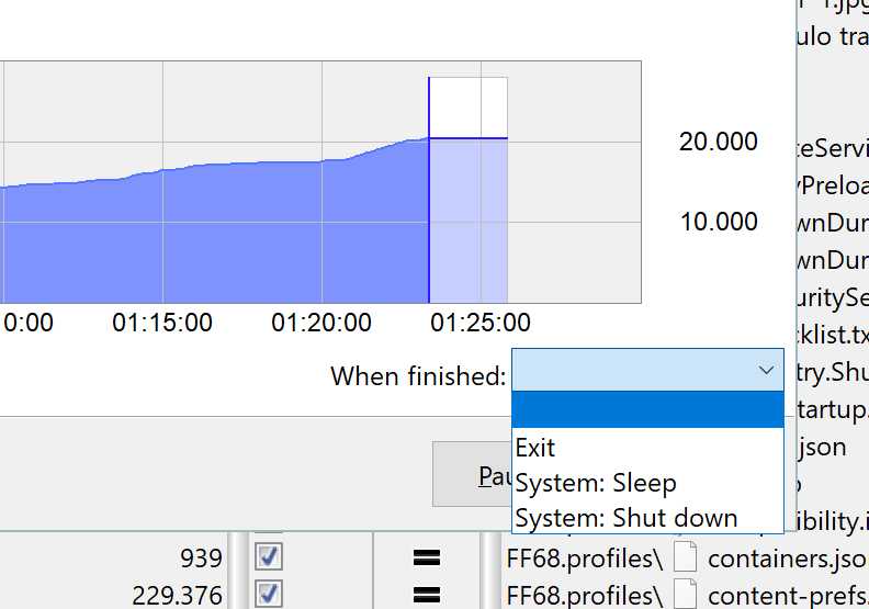

Not sure if it was previously requested.
.... but using FFS mainly as a batch, kicked up by TaskSched....
I would really appreciate to have this feature, instead of having to remember to check every day my logs.
Alain
Feature Request: When finished: Show Log

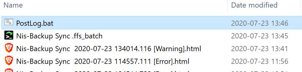

- Posts: 22
- Joined: 20 Jul 2020
The FFS help file has some info on calling batch files.
- Posts: 26
- Joined: 29 May 2019
My FFS.Batch file is run by taskmanager.The FFS help file has some info on calling batch files. toby9999, 23 Jul 2020, 05:04
... no idea how to run your command...
and if it's in a .bat file,
how to chain it at the end of FF.batch in taskmanager.
Alain

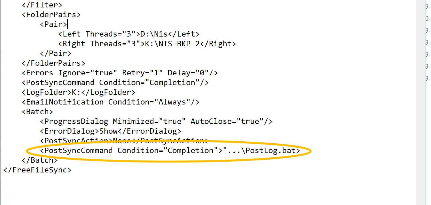

- Posts: 26
Perfect!!
A) New/Edit PostLog.bat
Add one line = "cat `dir /od- /b [......\...\F8-log-directory] | head -1`"
B) edit the FFS.batch:
Add one line = "PostSyncCommand Condition="Completion">"...\PostLog.bat"
Nothing else to change.
Correct??
Many Thanks
Alain

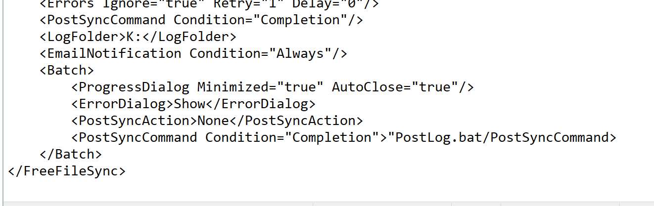

- Posts: 22
Looks good, but don't forget to add </PostSyncCommand> at the end of the PostSyncCommand line.
- Posts: 26
oooh...
forgot that
thanks!!
Alain
forgot that
thanks!!
Alain

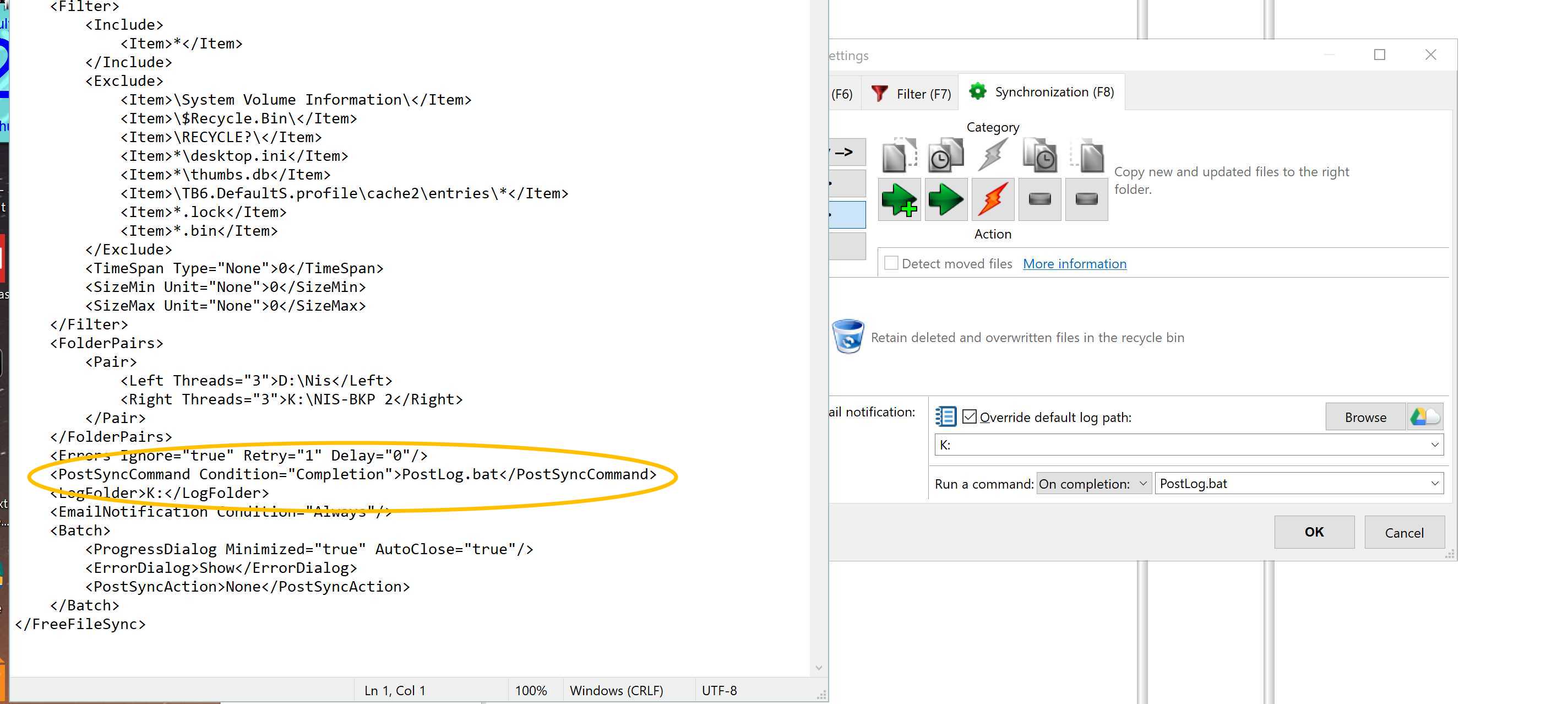

- Posts: 2997
For correct XML, your line should read:
possibly providing the correct path to Postlog.bat.
For convenience you may consider to use the FFS GUI instead of a text editor.
If in the Sync Settings (F8) you define the correct command line (e.g. Postlog.bat), and then save the FFS configuration (as a *.ffs_gui or *.ffs_batch file), FFS willl do the work for you and generate the correct XML code.
<PostSyncCommand Condition="Completion">Postlog.bat</PostSyncCommand>
- Posts: 26
Oh Wow your are so kind !!
So I deleted the line. Saved FFS.Batch file
did "FFS edit" F8 ... then saved it
opened with notepad an LO!
My problem is solved!!!!!
a big thanks
(unless I did something wrong into the PostLog.bat file)
a big thanks

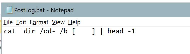

- Posts: 1239
I'm on Windows, & when I said "like", I meant like ;-).(I'm not thinking right but) something like...
As in what I wrote was a mixture of DOS & Unix commands (& syntax's).
So the PostLog.bat that you came up with actually does work?
And just what command line are you using in there?
- Posts: 26
ooops
I took it literally
and thinking back I've never seen the log appearing :-D
No, that .bat string doesn't work.
:-D

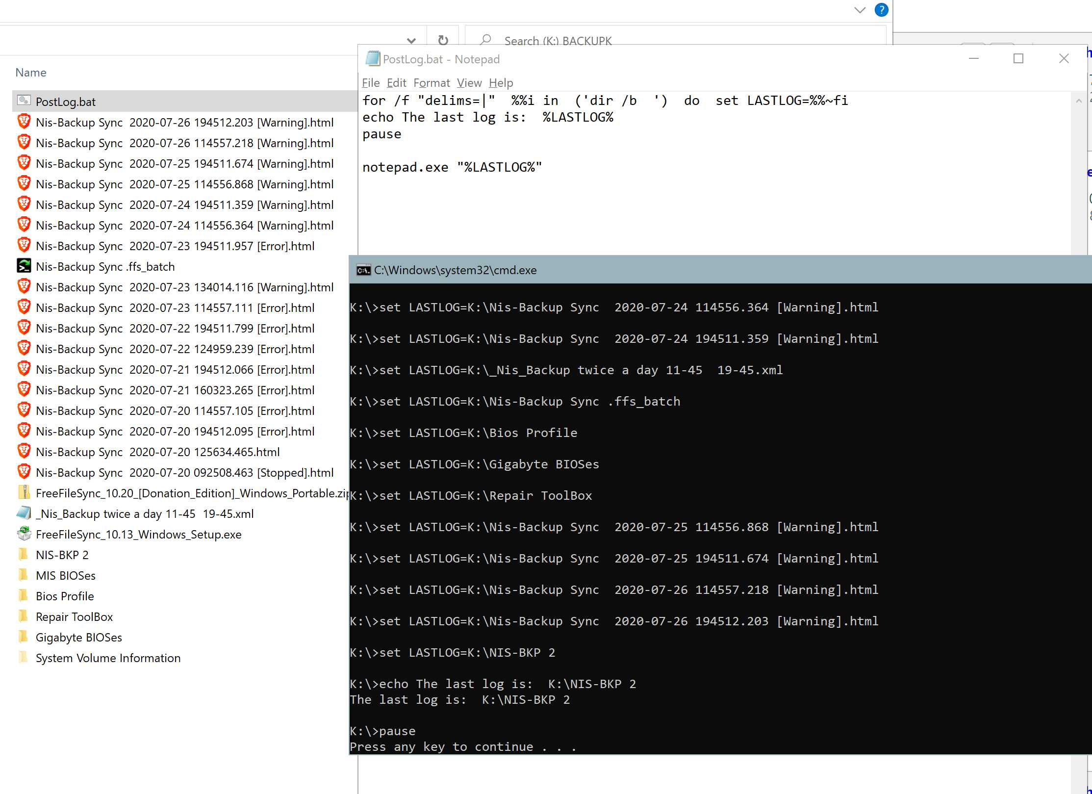

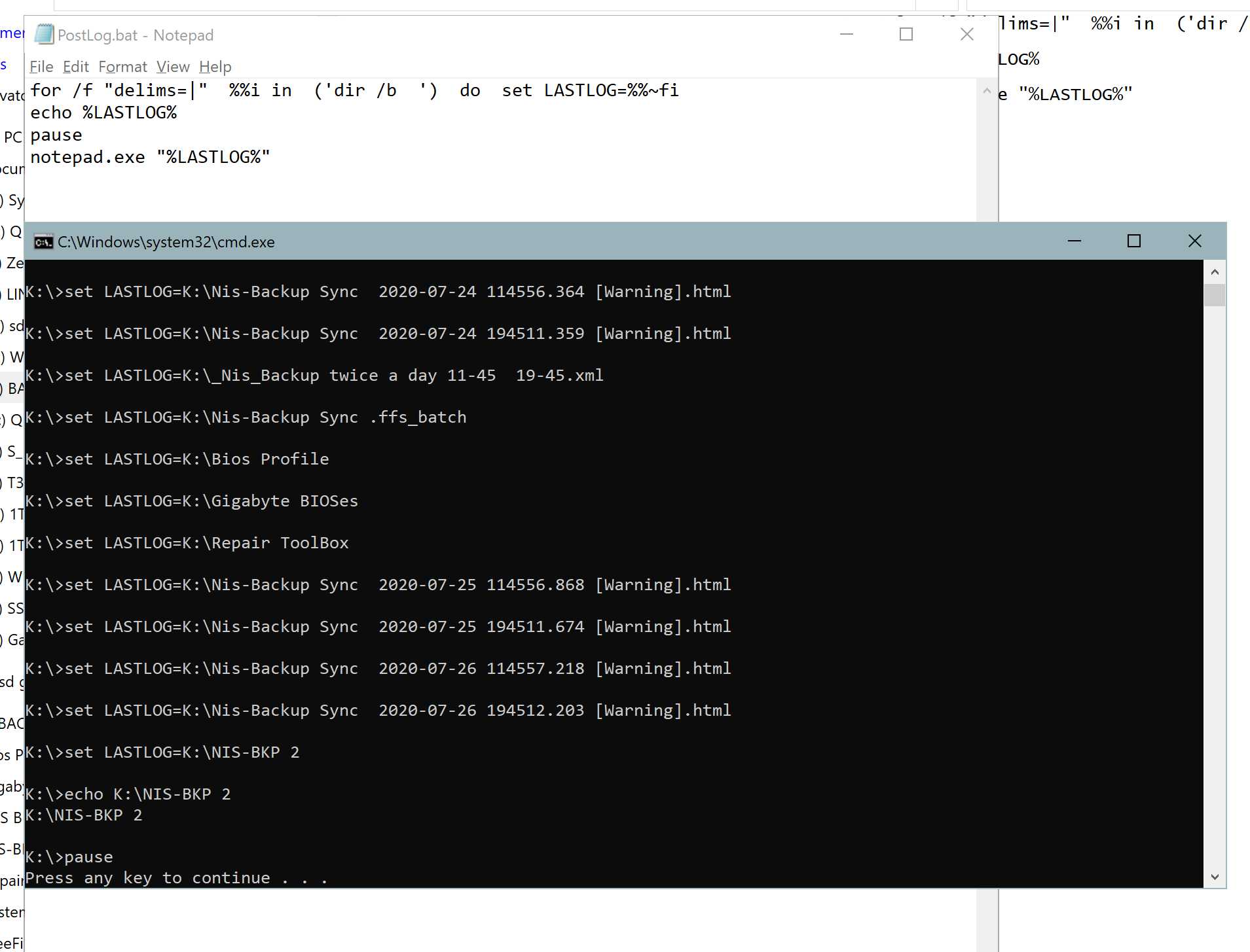

- Posts: 26
ok thanks
I'll change the Log dir and that's all I suppose.
everything is under K: root ... and K is a portable USB stick.
in pic 2 the results
Many thanks
Alain
Many thanks
Alain
- 2020-07-26 23 52 49.jpg (146.74 KiB) Viewed 2589 times
- 2020-07-26 23 49 10.jpg (99.65 KiB) Viewed 2591 times
- Posts: 1239
(I made some slight changes to PostLog.bat, above.)
In your case, you may want to change it again, something like, ('dir /b k:\nis*.html'')
(As it is, for you, it is finding "NIS-BKP 2", which would be the wrong file.)

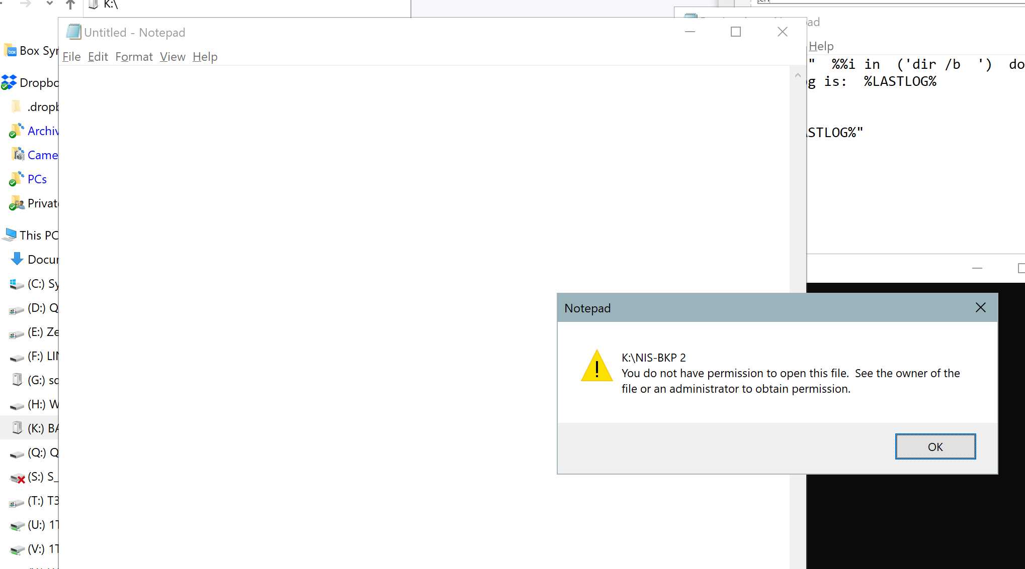

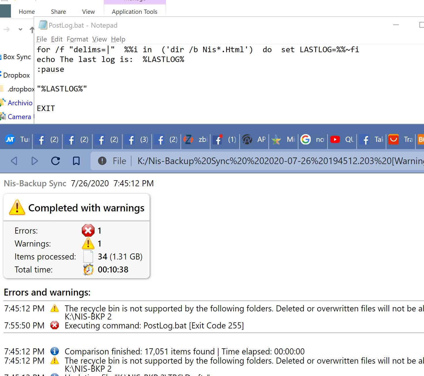

- Posts: 26
here's the new run.
with error after pause
- 2020-07-27 00 00 43.jpg (85.05 KiB) Viewed 2585 times
- 2020-07-26 23 59 24.jpg (257.36 KiB) Viewed 2587 times
- Posts: 1239
(As it is, for you, it is finding "NIS-BKP 2", which would be the wrong file [directory].)
When correct it should presumably display *194512*.html.
(Heh. But then, notepad won't help too much with .html, so maybe you'll want something like:
edge.exe "%LASTLOG%")

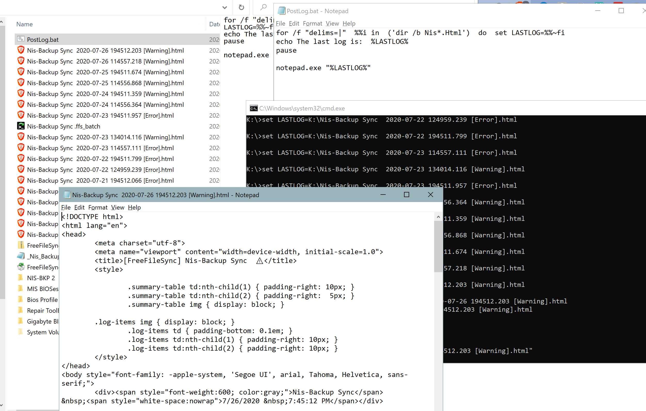

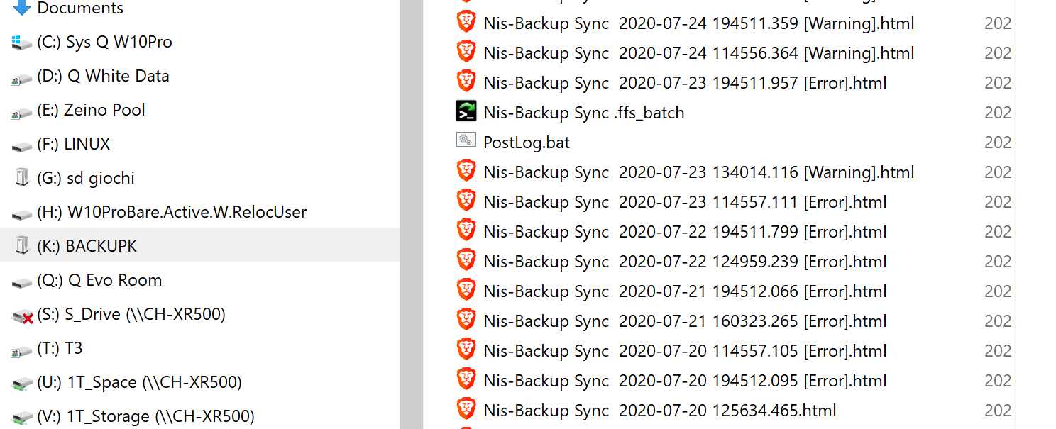

- Posts: 26
correct.
doing
Success !!!
a Great thanks !!
doing
Success !!!
a Great thanks !!
- 2020-07-27 00 06 55.jpg (316.7 KiB) Viewed 2582 times
- Posts: 26
better this way
it's an HTML it open in browser directly
You are Wonderfull !
Alain
Alain
- 2020-07-27 00 13 17.jpg (139.17 KiB) Viewed 2578 times
