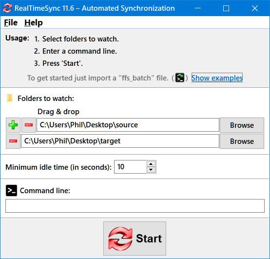

Here's what I did. I created two folders on my desktop called source & target. Then here's what I did.
1. "Start RealTimeSync.exe located in FreeFileSync's installation directory and enter the folders you want to monitor." Did this.
2. "Instead of doing this manually you can import an ffs_batch file via Menu → File → Open or simply via drag and drop." I did this using drop & drag. See attachment.
3. "RealTimeSync will not only extract all directories relevant for synchronization, but will also set up the command line to execute the ffs_batch file each time changes are detected." I took this to mean that RealTimeSync would automatically set up whatever I needed.
4. "Now press Start to begin monitoring." I did this & then got the above error message.

ad 2)
It does not look like you dragged a *.ffs-batch file into the RTS window, as the Command line instruction invoking FreeFileSync to run the specified *.ffs_batch file is missing.
Instead, it seems that you dragged&dropped the source and target location into the "Folders to watch".

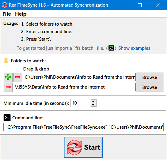

Set up the sync configuration in FFS and click the "save as..." button that corresponds to saving a batch job. This will create a .ffs_batch file that you drag & drop onto the RTS window.

Thank you both!. While I saw the "Save as..." in the upper right corner of FFS, I had never hovered my mouse over the one on the upper right to see the "Save as batch job...". I knew I was missing something simple.

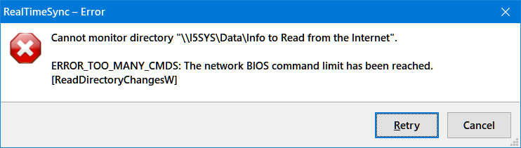

I followed the directions & it was working. However, I logged out & back in. I noticed that the folders were no longer being monitored.
So I started the RealTimeSync again & got an error message. In order to make it work again, I had to start freefilesync & double click the original job. Then RealTimeSync was able to monitor the fodlers.

2) Why would I get that error message?

2) That is an error from the NAS. Few results on Google, nothing clear

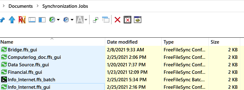

Thank you again for your reply. I don't have any files that end in .ffs_real. This is what I have:
I tried both a shortcut to & a copy of Info_Internet.ffs_batch in my startup folder & RealTimeSync wasn't monitoring after I logged in & out. So I'm not sure what I have to put in my startup folder or if there's another type of file that I must create.
Read my first reply in this thread
