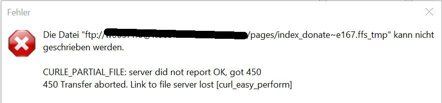

What could cause this error?
19:48:11     Error:     Cannot write file "ftp://ftp.XXX.de/sync.ffs_db.1c22.ffs_tmp".
CURLE_PARTIAL_FILE: server did not report OK, got 450
450 Transfer aborted. Link to file server lost [curl_easy_perform]
19:48:11     Error:     Stopped
It only and always happens with ffs_tmp files. All other files synced to the ftp-root directory work fine even that the above error is displayed. So its most likely not a permission problem. It seems that sync.ffs_db is not updated. The error does not occur when Directory on server is not root but a sub-directory.

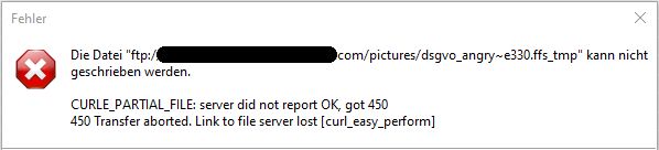

Now I get the above curl error even on transfers to sub-directories. This time the file which cannot be written is "ftp://xxxxxxxx.kasserver.com/scripts/tools~1be6.ffs_tmp" (the IP of the server is the same as in my initial post). With this error, I cannot use FFS anymore... :-(

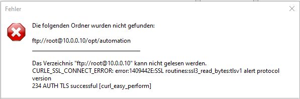

Update 10:49: Could already test the beta during a work break. Looks good. Did some syncs to the remote ProFTPD and to my own local Raspberry Pi based ProFTPD server (with TLS) and no errors so far.
If on my own ftp server only TLSv1.3 (no TLSv1.2) is allowed, the error in the attachment shows up.

Works on local server, which is ProFTPD 1.3.8rc1 now, with TLS 1.3 and TLS 1.2.
Fails on remote server with the error in the attachment. Seems not to work with 1.3. Installed the version with the 1.2 limitation again and that worked.

Unfortunately the error is still in 11.12...
