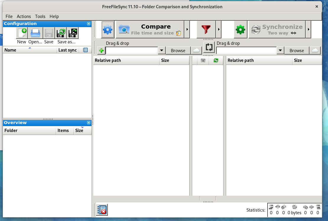

Just tested on Fedora 34:
should do the trick. The GUI looks like:
I guess this is the normal look of GTK2 on Fedora (while other apps use GTK3?).
