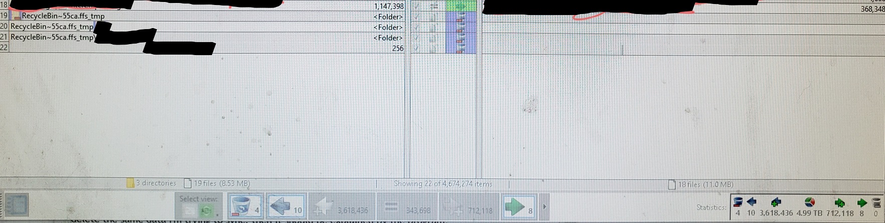

I don't mean to be rude, but if you don't know what's in the bottom right corner of the window of FFA, then that leaves me very concerned about the validity of your claimed assistance. Either way, this is what it looks like.
- Posts: 4866
If you search me on the forum, you can see the amount of posts I have made and come to your own conclusion on my knowledge. I just wanted to see what it said down there if you aren't able to see it in the compare window. Is it the fact that there are millions of files being displayed in the compare window that you can't see them? Are you using the display filters at the bottom middle after running a compare? You can select/deselect those to only show files that are slated to deleted

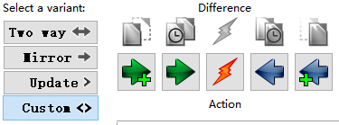

In a two-way sync FFS will delete the file if the file have been deleted on the opposite panel after last sync.I don't mean to be rude, but if you don't know what's in the bottom right corner of the window of FFA, then that leaves me very concerned about the validity of your claimed assistance. Either way, this is what it looks like.ffa problems 1.jpgdilbert99, 08 Jul 2021, 00:06
Use custom sync can solve this problem.
Click the green gear. Then set actions as below. Hope it works.

Thank you to both of you. It turns out, though I can't nail it down entirely, sometimes it will show on the list of files (the files to be deleted) and sometimes it does not.
I do not see how clicking the green gear and going to custom resolves this.
Though it turns out the files it always wants to delete are already in the recycling bin, which, I don't get why its a default that it wants to delete them, as if I wanted them deleted, I'd delete them myself. Seems imposing. Also, it turns out the buttons on the bottom center of the screen showing which types of files to show me doesn't always show the "files to be deleted". I cannot determine why this is the case.

Switching to "custom two-way" appears to have resolved the overwhelming desire of this program to delete my important files for no clear reason, but it seems like it should be a given that it shouldn't be doing that to begin with.

4. Yes, it literally deletes recycle bins. Here's a screenshot showing it doing so when I actually approved it. 5. The ultimate issue appears to be communication. This program does things that don't make sense, but also doesn't explain them or give various options in the settings. Many of the things you are saying could be mentioned in the program or be given as clear cut options before it disrupts someone's usage.
