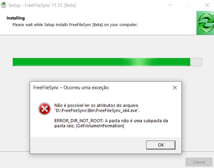

Thanks, but it still didn't work. (see attached images)
Error during installation:
"Cannot read file attributes"
"ERROR_DIR_NOT_ROOT: The folder is not a subfolder of the root folder. [GetVolumeInfomration]"

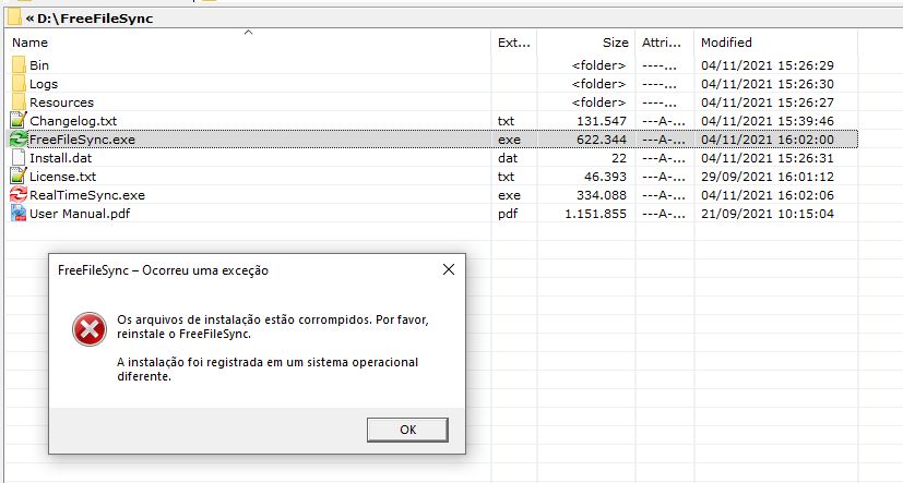

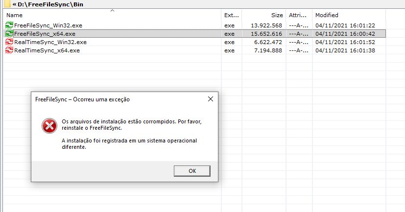

Error when trying to run the "primary" executable:
"The installation files are corrupted. Please reinstall FreeFileSync.
The installation was registered on a different operating system."
Error when trying to directly run the 64-bit executable:
The installation was registered under a different operating system."
