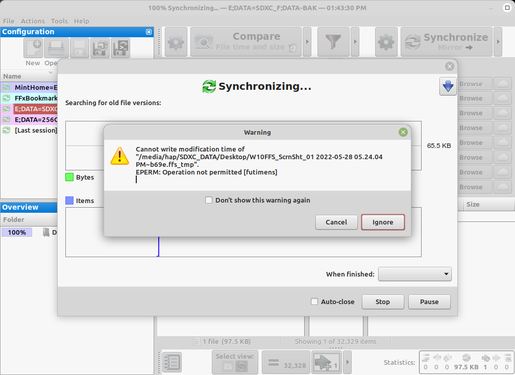

"Cannot write modification times" warning has just started showing up as of today.
My question is what effect will this have on future comparisons, or will it just be these annoying warnings?

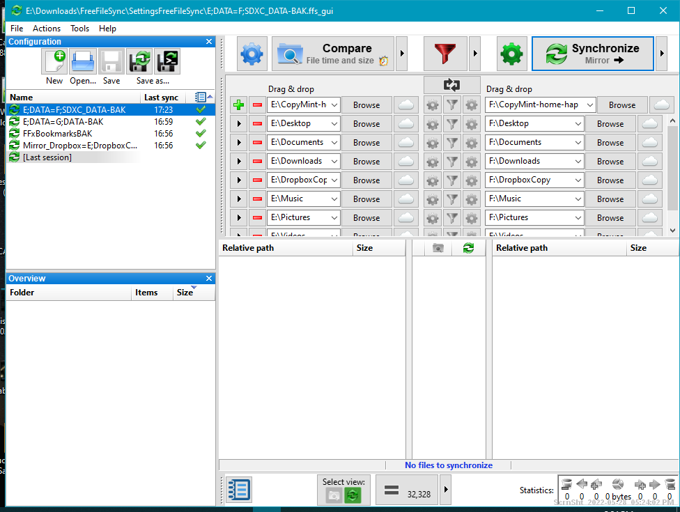

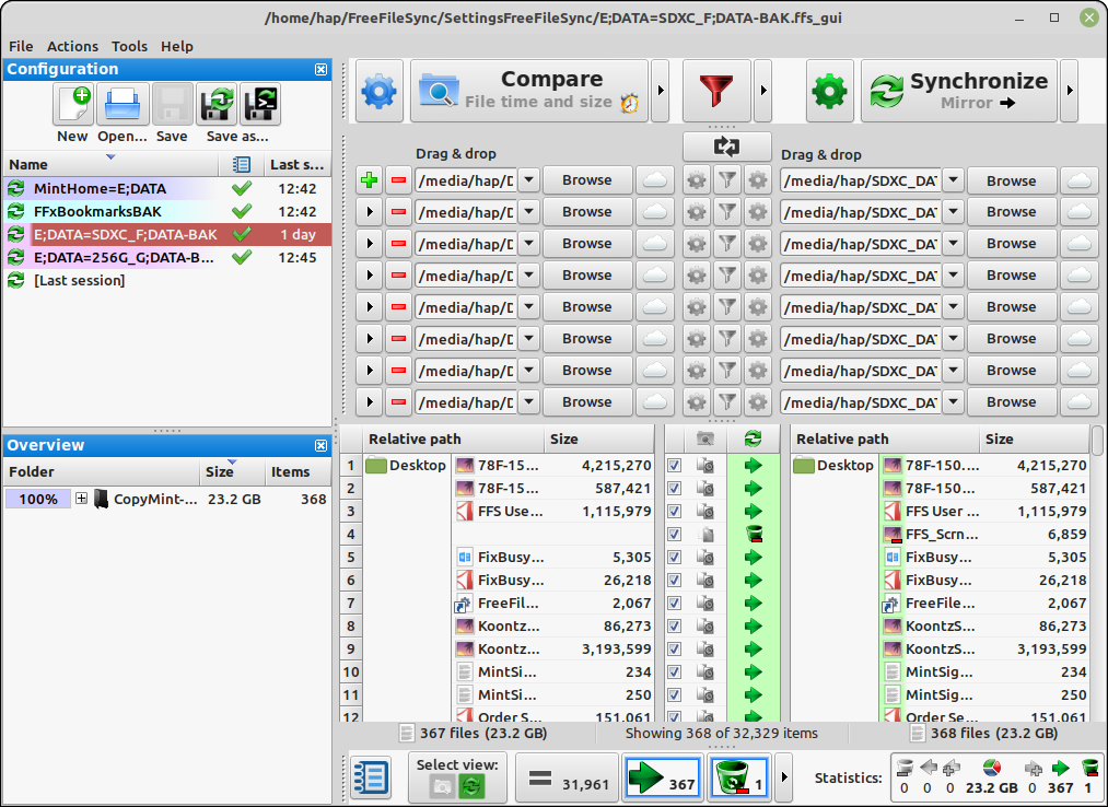

It appears that the lack of "Modification Time" being written, is definitely a Linux FFS issue, and not a W10 FFS issue. The "Mod Times" are written to the SD card backup media in the W10 version of FFS, but are not written to the same SD card backup media in the Linux version of FFS.
Linux ScrnSht of files that need to be written to SD card backup media that have been written to SD card media multiple times, using the Linux version of FFS.
W10 ScrnSht of the same Comparison as on Linux, after those files had been written to the SD media using the W10 version of FFS
The ScrnSht file above was then attempted to Comp/Sync to the SD card backup media with the Linux version of FFS, but again there was a failure to write the "Mod Time" of the file.

- Posts: 7523
The SD card is mounted into "/media/hap/". Whoever implemented this mount point apparently didn't implement "futimens" (and maybe even returned the bogus error code EPERM?).
Or maybe it is indeed a permission issue, but I don't think so. In any case, there is (most likely) nothing FFS can do about this.
